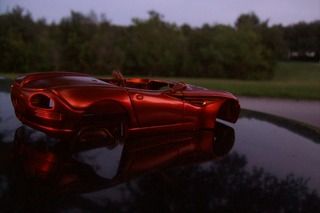

Here’s a diecast car shell that I’ve worked on/off for a while. Being repainted from a solid orange to a candy gold-orange appearance. I plan to have it finished by this summer and post a thread on it.
Before:
After/Ongoing:
