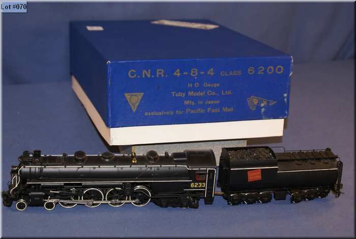

I am unfamiliar with this manufacturer who’s models were imported into Canada and the US by Pacific Fast Mail.
I am familiar with many of the other models imported by PFM such as United and those of Van Hobbies.
Is anyone familiar with this manufacture?. The model of a CN 4-8-4 is very well finished, it has the old open frame motor.
The engine is quite heavy, pulls well and after I replaced the magnets on the motor is only drawing .60 Amps. I was going to replace the motor with a can motor but that seems unnecesssary now. It has very good slow speed response.
There is a review of it in the February 1973 MR. No mention is made of the manufacturer, just that it is a PFM import.
Original performance report shows a minimum speed on filtered DC arounf 5 smph, current dra at full slip of .8 amp. Overall highly rated.

I found TOBY to be of superior quality to United, or other PFM builders. The most famous, IMHO, TOBY model was of the FRISCO 1500, 4-8-2. Released in the mid '60’s it demanded the exorbitant price of around $75 full retail then.
Toby was one of the top Japanese builders, building models for PFM, NWSL and other higher end importers. Not that United models were that much inferior, but Toby built models usualy ran like a swiss watch right out of the box. You found the trick to not having to can motor older brass, just replace the weak magnet. The gear reduction in these are usualy steep enough that newer can motors are about pointless if you just replace the weak alinco magnet in the original motor. For those that dont know, you can get replacement neo-magnets in various shapes, you can get them from Micro Mark. The button style are the easiest to stack in the spot where the original magnet was. This restores the motors power and lowers the amp draw. If you have an open frame that doesnt like to run slow, or runs hot, the magnet is weak. Beautifull model! Mike

Here’s an open-frame motor on an old Akane cab-forward that I replaced with rare earth magnets from Micro-Mark. They’re 1/8" thick by 1/4" wide by 1/2" long. They come 20 to a pack and they’re Micro Mark item #84991. The results in slow-speed operation, amp reduction and noise level has been astounding. So far I’ve replaced magnets in about 6 of my older open-frame motors, and the locomotives run better than they ever have before.

You CAN assume that…enjoy your model. I thought the blue box was interesting. I am used to seeing TOBY in green boxes.
