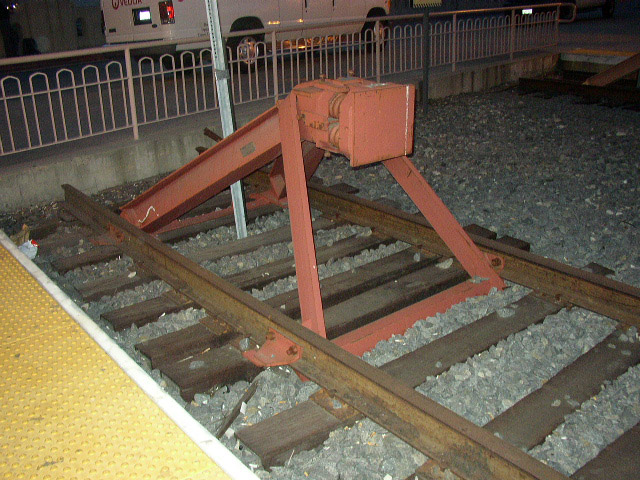

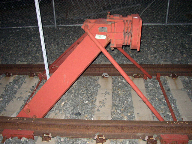

I was at Los Angeles Union Station earlier this evening and snapped the track bumpers at the terminal. Check out the springs! Maybe you can use some spare Kadee coupler springs…
The metal pole behind the bumper has a sign that reads “END OF BLOCK.”
