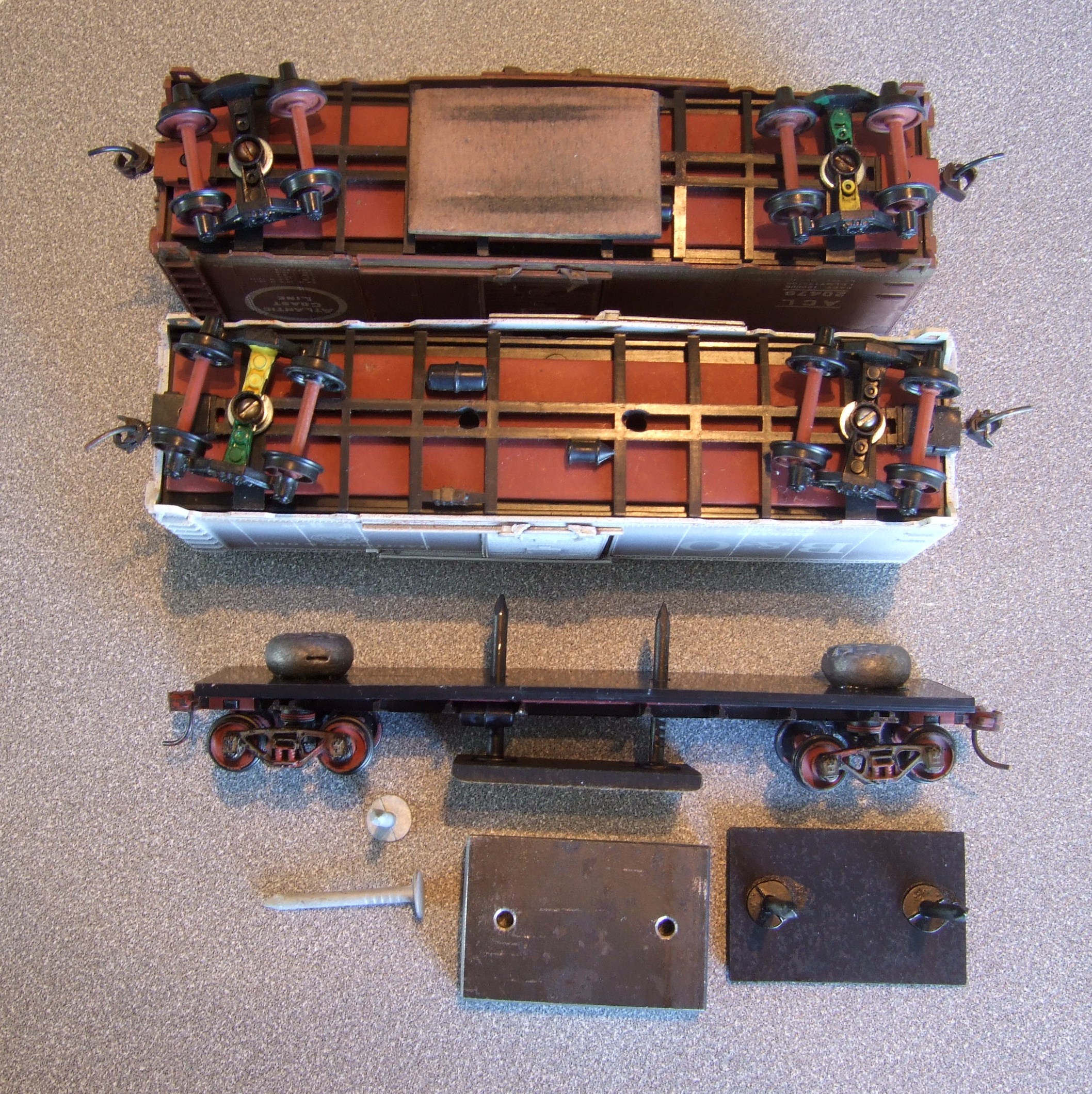

Gidday, My favourite, “The John Allen Track Cleaning Car”.
DSCF6492 by Bear, on Flickr
Local policy is that all trains must have at least one cleaning car per consist. A quick light sand of the masonite pad when required, (and it is required on that pad !!).
Cheers, the Bear.

I also favor the John Allen track cleaning type car. I also prep my track after doing any scenery work in any area.
First I use a bright boy to clean the track. There are different grades of Bright-Boy blocks. I favor the softer ones. Perfect makes one that is yellow and has a finer abrasive than most.
After cleaning with the Bright-Boy, I run my finger over the rails to remove the grit left behind.
Next I apply some WD-40 by spraying some on a finger, then rubbing it on the rails for a foot or so.
Next I run a train through it to distribute it around the layout. This helps with the conductivity and does away with the dry track, but does not oil it. (I have used Rail-Zip before and do not recommend it as it builds up.)
Once this is done, I keep the track clean from this point on by running the Masonite pads on some box cars. I try to have one cleaning car in each train. I also have a Masonite cleaning pad that is weighted that I use “once in a while”.
