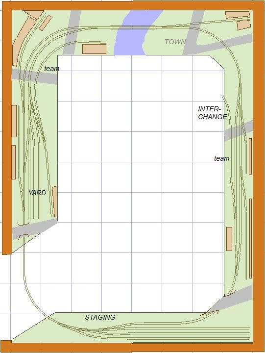

i found these ones, though they are not suited to modern model railroading. Long modern freightcars (89 ft) require a 32+ inch radius and #6 or #8 switches.
As you can see a drawing of your room would be welcome. The “behind the backdrop” scenes are at the open side facing the room.
The second plan is greatly influenced by the HOG and has a 24" minimum radius; the third is a Pelle Soeberg design redrawn for a smaller room.

HI where did you find this?
hi Noname
you 'll be disappointed, such a database does not exist. Some “would be” designers have a database of their own, beside having various books about track-planning.
Planning starts with a drawing of your room and dreaming about the trains you would love to run. Easily said but how do you envision running them? And do they fit on the radii and switches you are planning to use?
Designing a railroad with a long main with broad radii suited for long modern trains (and cars or coaches) is quite different from a layout tailored for the wayfreight or a local switcher in the fifties.
The original design by Pelle Soeberg had 32+ radii and due to the grades to get to the underground staging area no other stations then the one before the east wall. His layout was not designed for loads of operation, he kept it pretty empty. Long modern freight trains however do have space to run and are looking great on his pike. And some local switching, including the plant on the peninsula, is possible too. In this design you could let the the trains cross each other by a bridge build at the south wall, before the lower track disappears into staging.
It is up to you to come up with your wishes and to come up with a possible trackplan. Only if you know where you are heading to, people on here are able to help you. I have some money and some space, please design me a house is not enough.
