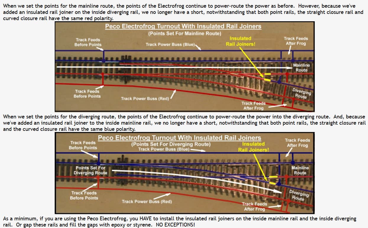

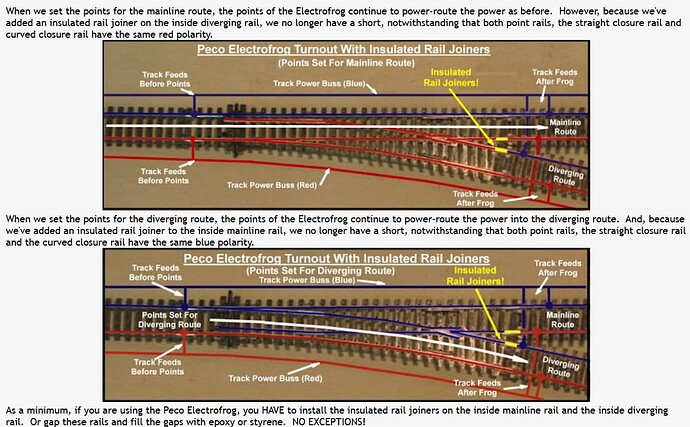

Since you are just beginning, if you’re like me, all the talk of cutting and putting in gaps or insulated joiners gets confusing.
Even though this is for Peco turnouts, I think it will also work for you. If I am wrong about this, someone please correct it. I’m not an expert at this!
At the least, it shows where to cut a gap or put in an insulated rail joiner. (If you can cut a small enough gap, the joiner isn’t really needed.)
https://railwaybobsmodulebuildingtips.blogspot.com/2013/01/the-peco-electrofrog-circuitry.html
Having first gone with DC and then upgraded the layout to DCC, I would suggest sticking with one. DCC has a somewhat steep learning curve and requires your track work and electrical being spot on, but the the joy of having multiple locos running simultaneously.is worth it!
If, indeed, the Kato turnouts are “power routing”, then the Peco Electrofrog illustrations are applicable. The two “inner frog” rails would have to be gapped to avoid dead shorts. I am not familiar with Kato turnouts, but they are supposedly power routing.
