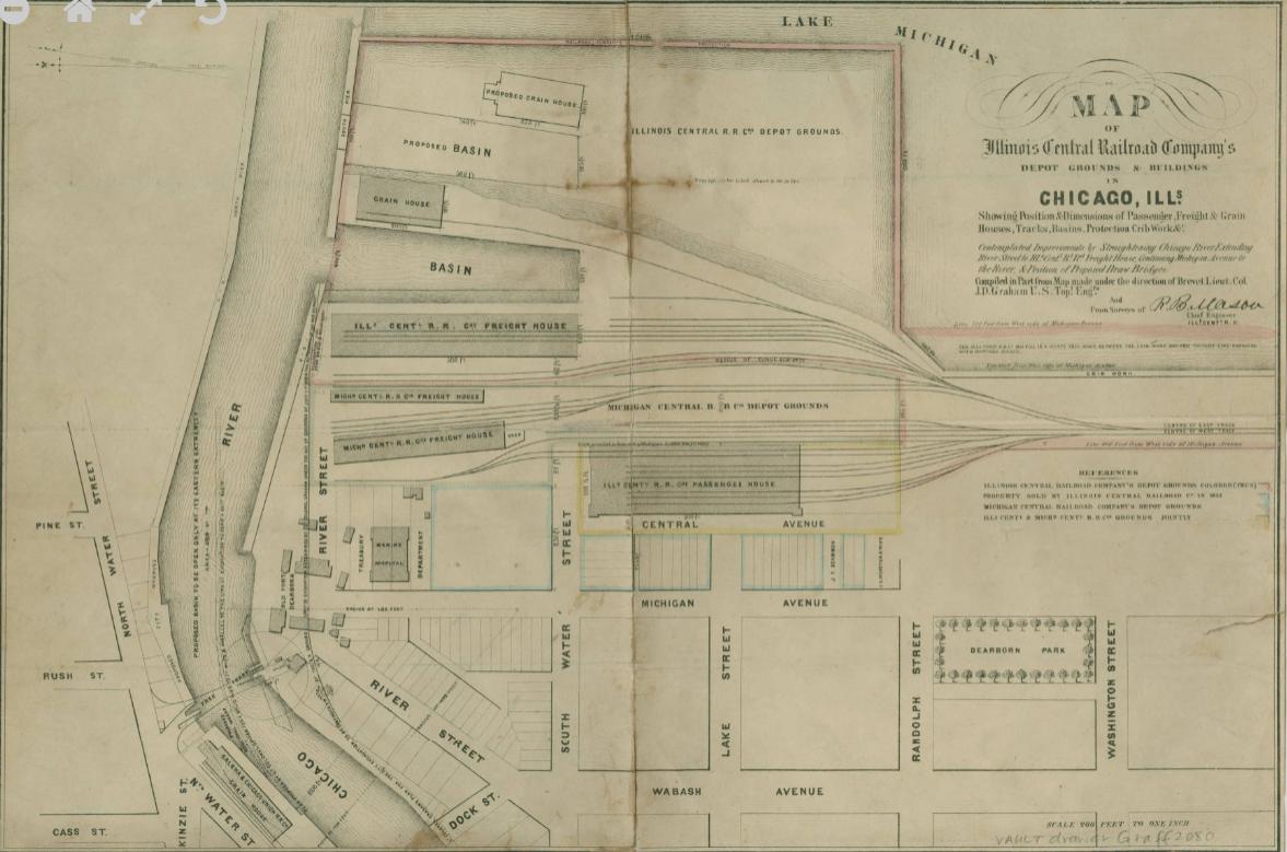

I just came across a very nice map of the South Water Street terminus of the Illinois Central Railroad in downtown Chicago The ICRR was the only one of the 6 railroads to have two downtown stations, the other one being at 12th Street on the lakefront. This map can be found on the following website
Source: Map of Illinois Central Railroad Company’s depot grounds & buildings in Chicago, Ills. - Chicago and the Midwest (Newberry Library) - CARLI Digital Collections
Now that is a great map! Notice the Michigan Central freight houses, something I never saw before. The current Millenium Station is pretty much on the same footprint as the passenger station on the map, though of course now covered with buildings and Millenium Park. Some or all of the waterfront track was electrified between 1926 and 1941 as part of the Suburban electrification, with steeple-cab electric locomotives, later bought by the South Shore Line.
