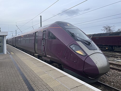

All the CEM in the world probably wouldn’t have helped the driver of the 360. This is the nose profile of the Aurora he hit:

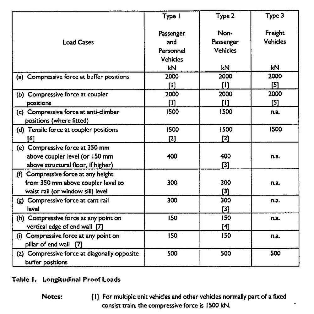

The European crashworthiness standard EN 15227 doesn’t cover all possible accident scenarios.
Quote from EN 15277, 1. Scope from 2005 draft:
Quote EN 15277 - scope
Source: https://de.scribd.com/document/475157811/EN-15227-Railroad-crashworthiness-standard
The website contains a link to a pdf but you need to register. Otherwise you need to scroll down to page17, Annex A
As far as I can recall, EN 15277 covers approximately 90% of the accident scenarios recorded in statistics.
Regards, Volker
PS: The 2005 draft was the newest I was able to find on internet. To get the standard you need to pay even for a draft for comment.
Here is a direct link to the 2005 draft: https://www.roadsafellc.com/NCHRP22-24/Literature/Papers/EN_15227/EN%2015227_Railroad_crashworthiness_standard.pdf
