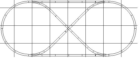

You mean like this?
If the spur connects like the picture above then, “yes”, because it creates a reversing loop. It will require more than insulating connectors. Conventional blocking will require 2 DPDT switches for DC and 2 automatic reverse units for DCC.
By the time that I got down to TZ’s reply and the attached track diagram, I had visualized the same track configuration. If that is what the OP put together, then he has definitely created some reverse loops.
