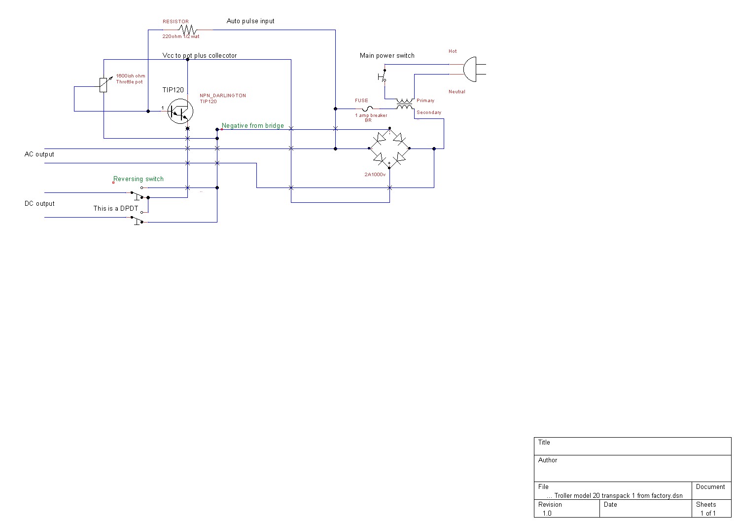

I’m starting to get buyers remorse for picking up a Troller last weekend from a train-show. Can you draw out this as a wiring diagram so I can attempt it? (Newby here).

so any rate, I just picked up a momentum 1 to run the tree layout, so I took ole ironsides apart (a transpack 1 - model 20) to delve a schematic, improve it, clean it up and make it work better.
I am about ready to upload the schematic is a .png or .jpg or a tiny cad file.

  1. the bottom line model - this model 20 uses a TIP120 darlington which has a continuous collector current of 5amps and a Pd (power dissipation ) of 65W, for a unit that sources 1amp of 12ish volts DC, this is more than enough
  2. all the parts inside are ‘bare minimum’. While yes it does have a full wave bridge inside, its a 1 amp bridge using what looks to be 4 1N4001 series diodes. These need replaced with 3amp fast recovery diodes, or a monolithic bridge, I just so happened to have 20 2 amp 1000v bridges in stock so this will do.
  3. they are protected, per throttle with a glass tube that looks like a light, its a thermal fuse and in this case, rated at 1 amp, they are yes, on the line of slow blow, the fuse is on the AC secondary BEFORE the split for the rectifier and AC accessory output so its 1 amp TOTAL. If yours is defective or aged, look into a 1amp breaker that works on AC. To non-destructively test your breaker, take a 10ohm, 10w cement resistor and short the AC output terminals - it will pull only appx 1.5 amps or less, not harm the DC side and while the cement will get warm, it will do the job to prove she pops.
  4. the heat sinking of the Darlington is suspect, in the model 20 it is a nice large piece of aluminum but the Trans is only clipped to it with old thin mica - if in fact its mica, and dried paste, I modernized this and bolted the Trans to the heatsink firmly and got rid of the rivets and bolted the heatsink to the case.
  5. the mythical ‘autopulse’ made people think there was some sort of a gizmo in there or computer. Not at all, from the same leg of the transformer to the rectifier a tap was taken of pure AC, passed thru a 220 ohm, 1/2W carbon comp and fed into the base of the darlington and summed with the output of the 1600-ish ohm potentiometer. Think about what this does…because the DC rectifier is full wave and our AC is 60hz, in 1 second on a scope you see 120 humps going from The Vf of the diodes (prolly around .6v) to the max AC it can produce minus Vf, with the overlaid/summed signal you see in the same 60 seconds 60 small additions, and 60 small subtractions. when the pot is at zero, the humps are imperceptible if even there on the base due to the resistance and the signal from the AC injection does not exceed turnon voltage of the darlington (typically 1.2-1.4v). As you get the train moving, at speeds not in scale, the pot output exceeds the injection so it becomes lost. Its…automatic!
  6. but this is where the overheating comes from, those humps do go from Vf to whatever meaning they ARE turning off the darlington 120 times a second. this builds heat as it never gets into and stays in saturation. And it acts like HALF of a 120hz AC signal which is after all ‘fake’ DC - heating up the motor in the loco. If you like scale speeds, which is what these transformers were built for, its counter productive.
  7. Implications for improvement I am toying with the idea of using a small value capacitor, like under 47uF, but higher than expected voltage - 50v to fill in SOME of the void between the humps, it will charge fast and deplete fast but its not MUCH storage, this should keep the voltage on the darlington once you get continuously moving, to above 1.2-1.4v. This cap will be placed across the high leg and the ground leg of the pot, which means if is cleaning up the voltage seen at the collector, the base will still see a much lower voltage, much lower current signal at the base, along with the pulse injection. I may have to re-bias the pulse injection to a 180 or even 150 ohm resistor, and I might place in series with the rectifier to the collector another 10ohm 10W cement. why? At WOT the throttle has 14 ohms on it. by adding 10 more, it will mean the throttle can NEVER get to 1 amp and it gives a larger operating range, move movement and prevents ludicrous speed, which we do not want. and it should still run multiple lashups if anyone does that.
In conclusion, this is where the ‘troller project’ is now, I will apply each thing found to all my units as well as make available the schematics.
Oh and yeah, I will put in parallel with the breaker a 1amp diode feeding a red LED and a 470-1000ohm resistor and placing this in a holder in the top of the case, if the breaker pops the light glows…
BTW, by this point it is apparent that any of the old rheostat driven units can be converted to transistorized for about 5-7 bux using parts from mouser. some of them had mighty big cases.

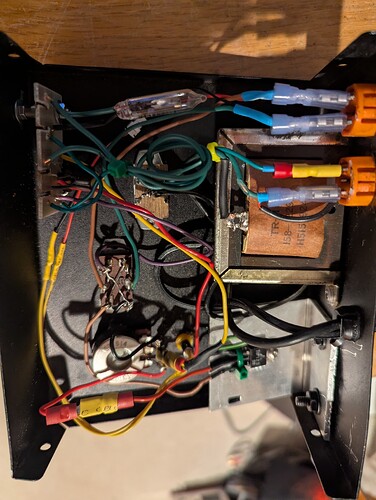

I have several Troller packs that I have used off and on for the last 50 years. As JasonSilver posted four years ago, I wish someone would post a diagram (of the dual brake light overload protection). I would also like to see pictures of what is inside a Troller case; which components need to be replaced (or tend to fail), and what modern components (with sources).

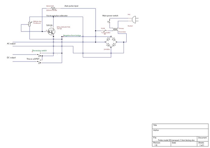

ok here is a jpg representation of a schematic from ‘tinycad’ of the transamp series. IF the model number indicates more than 1 amp, just assume some of the parts may be larger.
In THIS instance of you wanted to replace the diodes with larger and not use a bridge, 1N5408G are 3 amp 1000v fast recovery diodes. (from mouser or digikey) Just replace as you would any diode. if you want to use a 4 legged bridge, is the same theory.
The TIP120 used in this is still available today in that part number from mouser made by both STM and Onsemi…the onsem is a wee bit cheaper.
Note on price: I dont wanna really list prices unless I am asked specifically, since I restore vintage electronics (read: stereos) I order parts in the hundreds each time so I get very real bulk discounts. For example the STM TIP120 is 1 buck for one, but 46 cents each if I buy 10…
To mount the transistors properly just google up TO220 or universal transistor mount hardware kits…it will contain micas, sil pads, nylon washers, nuts bolts etc.

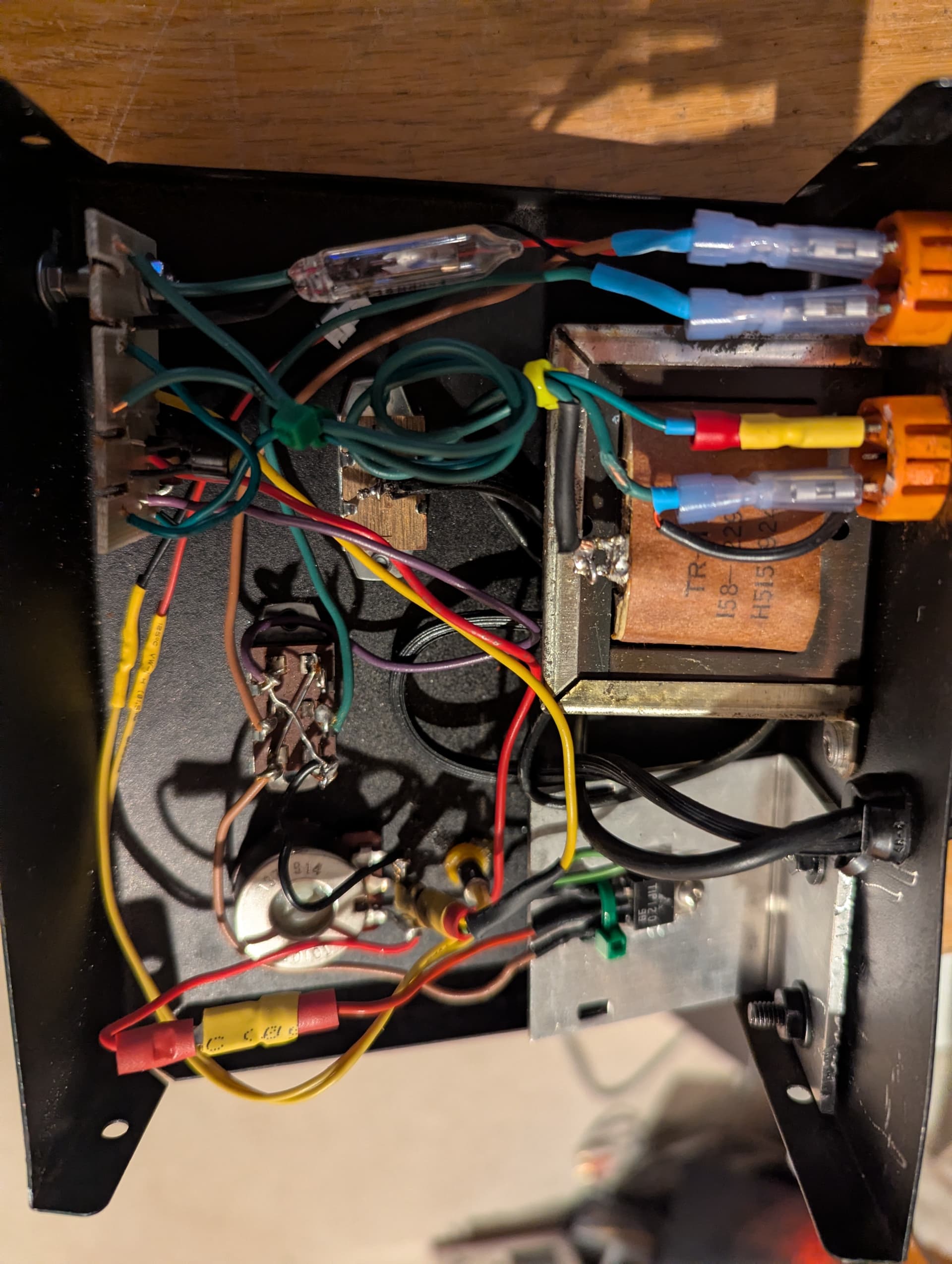

and now here is a pic of a transamp 1 cleaned up and separated inside, I made the wires long enough so components can be ‘pulled out’. I was copying troller and using solid 22awg wire, I think I will use stranded for now on. Note the biggest feature - the circuit board now mounted in the upper left of the pic was the one soldered to the terminals. that makes them IMPOSSIBLE to take apart, so use a hot gun/pencil and solder wick to remove it. we find that like the outside, the inside is ALSO 1/4 inch blade terminals which we can get female crimps for, anywhere…
