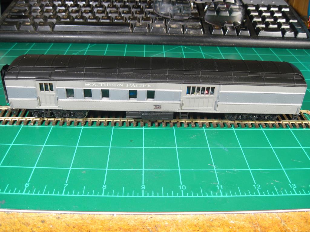

I’ve been using Tru Color Paint for about 6 years now and you can put me in the Swear By Camp. I only use SP colors and they are great!!!
I was able to buy TCP from my LHS up until about six months ago when his supplier dropped TCP. I had to revert to eBay for the last couple of bottles.
As good as if not better than Floquil.
