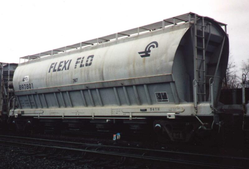

Now I found a number of images of the 'HO model car when I googled “AHM Flex Flow hopper”
a Details Kit for these cars,…wonder if it got into production?
http://www.planomodelproducts.com/10930/10930.html
A very nice rebuild discussion on this forum, by a guy who really does EXCELLENT work, Bobby Pitts
http://atlasrescueforum.proboards.com/thread/2615/ahm-flexi-flo-hopper-bash
On the Plano website, you can also see Sean Steele’s build. I think it was Sean’s project that prompted the “kit”. Sean used stock walkways and railings, and did an extensive article about it, which I believe was on the “Diesel Detailer” site, but now you can buy the kit from Plano.
