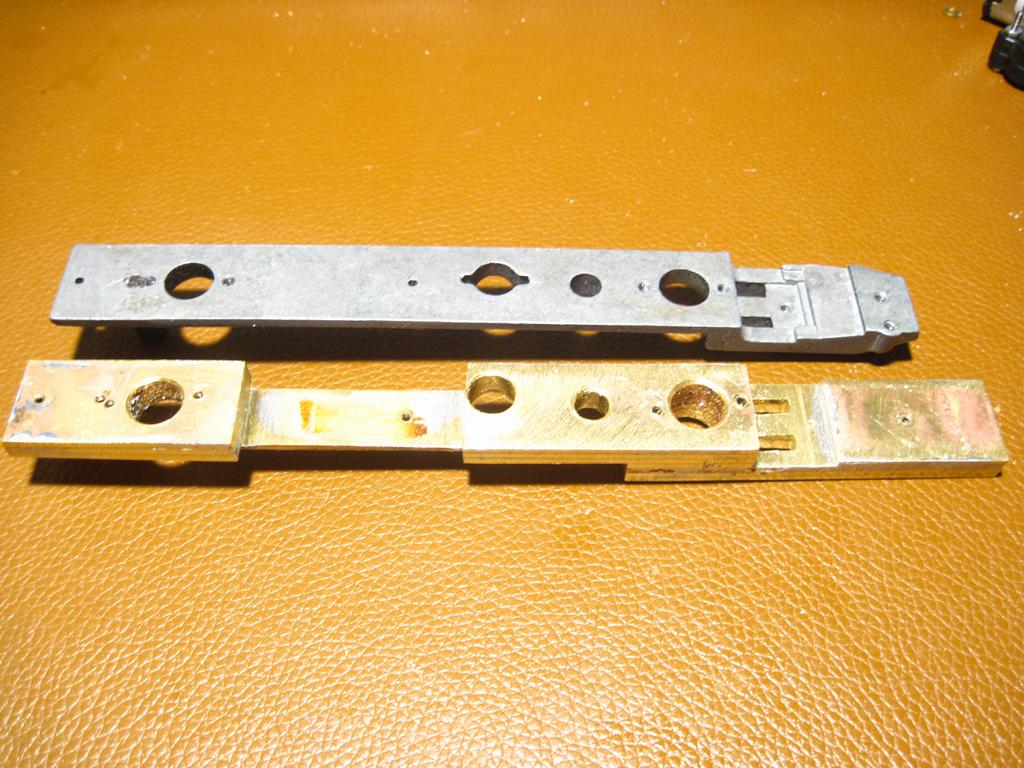

The older Blue Box Athearn frames are easily kitbashed to change the length. To fit the Rivarossi Krauss Maffei shell to the Athearn PA frame I cut the frame and extended it about a half inch.
The Athearn six wheel trucks are nothing close to the Krauss Maffei trucks but I’m not a rivet counter so close enough works for me.
Since most HO equipment is assembled with metric screws I stock most smaller sizes of metric hardware, M2 to M3.5 and several sizes of K&S Brass Strips.
I even build up frames for my Rivarossi articulateds.
This brass frame will be fitted with a pair of motors replacing the original motor.
Mel
