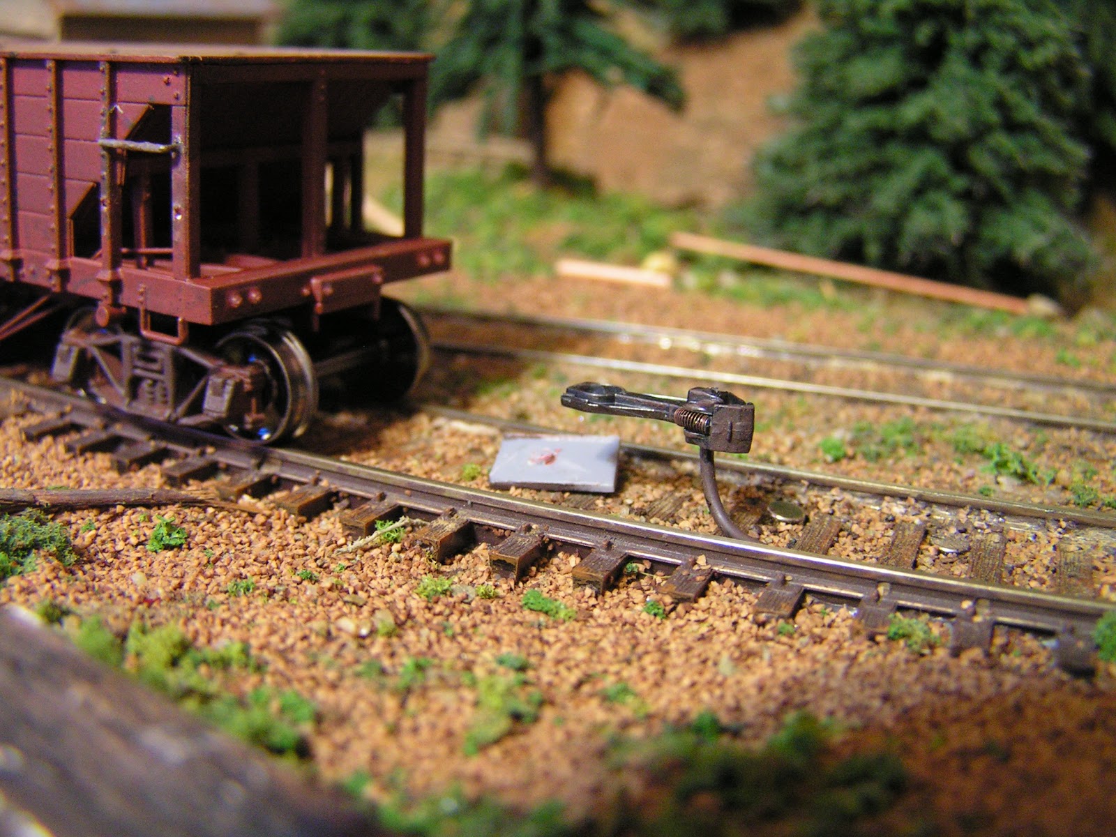

Geared Steam Funny picture

I have had several problems like Geared Steam, a loose coupler pocket or coupler cover and you will have a ready to reinstall coupler. “Tain’t funny McGee!”
