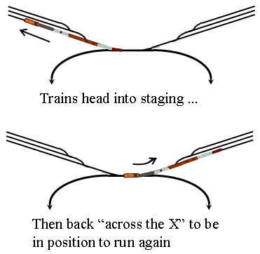

When I wrote the article on X-Factor staging in MRP 2004, I just gave a name to a configuration that’s probably been around for a long time. Two hidden stub-end staging yards face one another across a short section of (typically) hidden track, as seen below. This relationship suggested the letter “X” to me.
Trains may pull straight into staging when they complete their run over the visible layout. Later they may be backed across the “crux” of the X to the other staging yard, ready to run over the visible layout again, as seen below.

Worked great, even backing strings of N scale cars with truck-mounted couplers. Each staging yard sloped gently down to make the backing move more reliable. I’ve since used it on other designs and it seems to work fine.
