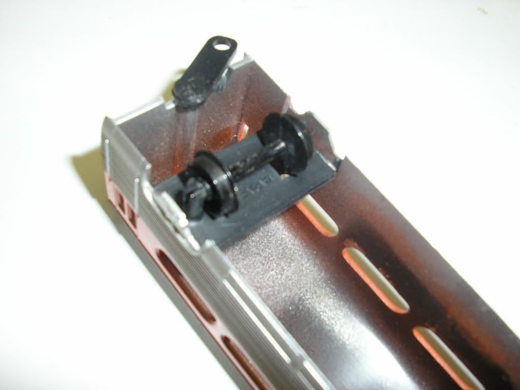

I have just purchased a Varney Aerotrain in near perfect condition. It came with the Varney power conversion kit. The unit runs ok but I have ordered neodymium magnets to see if I can improve performance before I spend money on a new motor.
My question is about the plastic wheel sets and their mounting pins. The axles rotate in a hole in a plastic post. The axles are not tapered. There is a slot in the post to allow the wheel sets to be removed. I don’t think tapered axle wheel sets will work because if the posts were cored to fit tapered axles there would be very little material left. Also, the post is styrene so it would wear out over time. Here is what they look like. Sorry the picture is a bit blurry:

Check Northwest Shortline for their blunt end axles, they may have something that fits
http://www.nwsl.com/uploads/cat_chap3_for_web.pdf
G PAINE
Thanks for the NWSL lead. Looks like their wheels will fit. They also sell bearings but I don’t think there is space to mount them on the existing axle posts.

If there’s one thing I know about old Varney products, it’s that their freight/passenger car wheels are terrible! I don’t have a single Varney car that hasn’t had its trucks replaced. NWSL’s blunt or shoulder axles should fit well, and the steel axles should roll better than those molded plastic axles even with the stock mounting.

The NWSL 36" wheel sets #37108-4 were a near perfect drop in. The only modification was a tiny bit of shaving of the inboard sides of the axle posts to clear the axles where the smaller diameter on the axle ends and the larger diameter axle starts outboard of the wheels. They spin relatively freely, but not nearly as smoothly as a tapered axle in a delrin truck. I am not sure if I should try to lubricate them or leave them be. Any suggestions in that regard would be appreciated.
