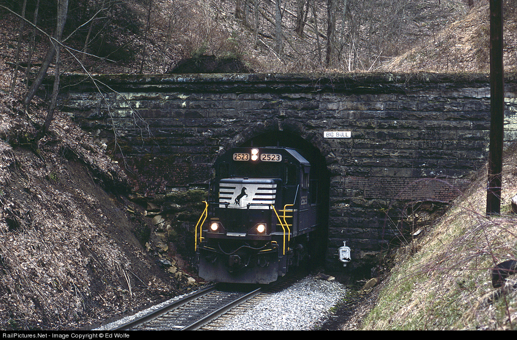

An example:
I have read about covered hoppers coming out of this tunnel being too hot to touch from rubbing against the walls.
I suspect that is a myth or there would be paint scraped off. If that is true the heat is probably from the diesel exhaust heating the cars.
