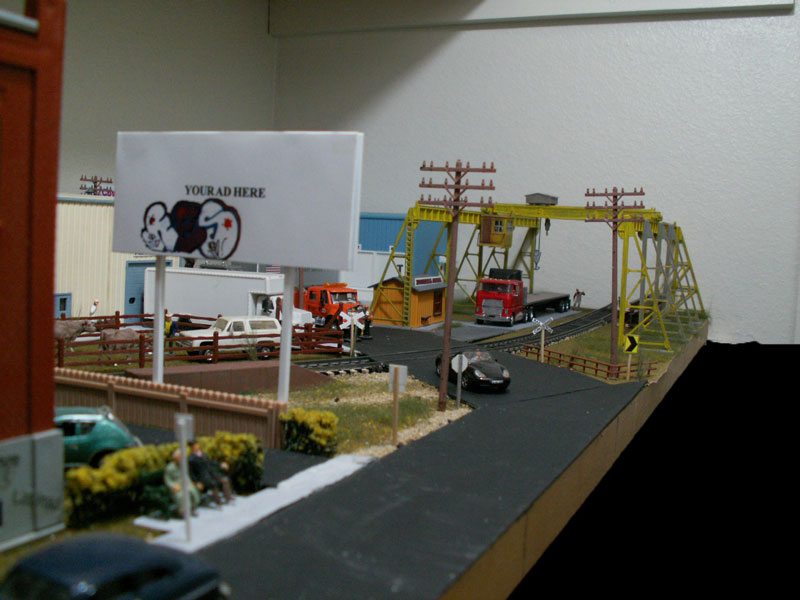

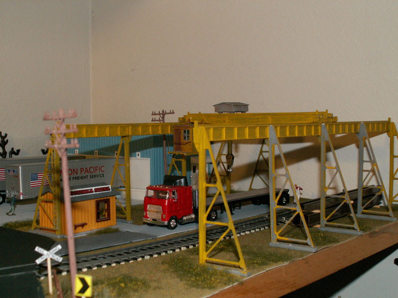

Foothill Steel
Silly me, I forgot to paint one side of some of the legs. I never noticed it in person but the pictures don’t lie.
