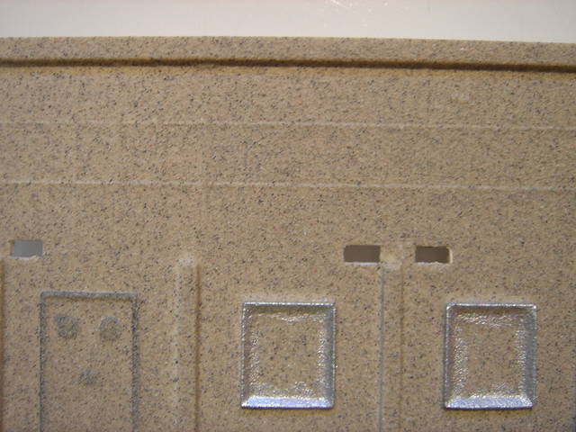

I picked up a can of Rustoleum “speckled” paint for my cobblestone plaza. I also used it on a rock wall, and now I’m trying it on a building. Maybe I’ll get a picture out in a couple of days. It’s an easy way to get a uniform textured appearance on any surface without resorting to an airbrush. I’ve got a can of light brown, but there are others available. In fact, I’m going to look for a dark gray to use for a roof surface, too.
OK - weekend update time. Here’s a picture of one wall of the theater:
The silver frames have been painted and are awaiting theater posters I’ve downloaded and printed. The rectangular holes are for mounting the overhang which I haven’t installed yet.

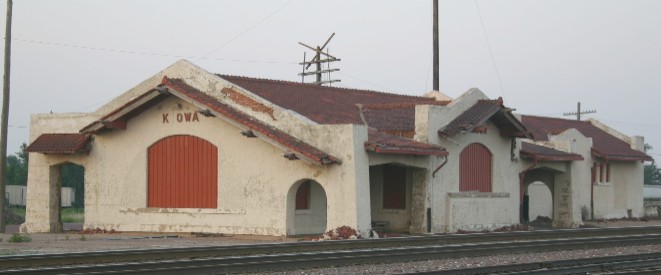

The color would depend on the age. The Kiowa station (RIP) ended up almost yellow. In the hobby store look through the paints for ships sails. Canvas colors often work well for weathered white.
Former AT&SF station in Kiowa Kansas. A unique Mission Style:
As you can see the trim was a brick red that matched the tile roof.
If I’m not mistaken, the Kiowa station was actually brick that was stuccoed just the the station in Great Bend.
Ch
Yes, the main structure is (was) brick, but it was designed for stucco from the start. The mortar on the outside layer of brick is (was) rough, with the wire mesh integrated rather than added on. I’ve got a photo of that somewhere too because I thought it was an interesting design. The bricks came from Coffeyville Kansas.
