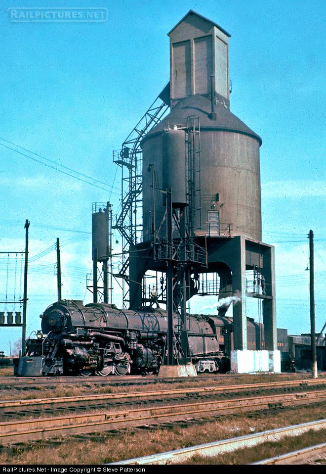

Kevin,
This one appears to be a two-track coaling tower. There is no third track on our side, and the other side is for loading the tower. So, yes, it was done:
Ed
Wayne & Ed: Thank you for the replies and the very helpful pictures. I figured it would be OK because in the real world everything is built to fit and meet customer needs.
I only want to avoid that situation where something is so wrong that it will actually bother me.
