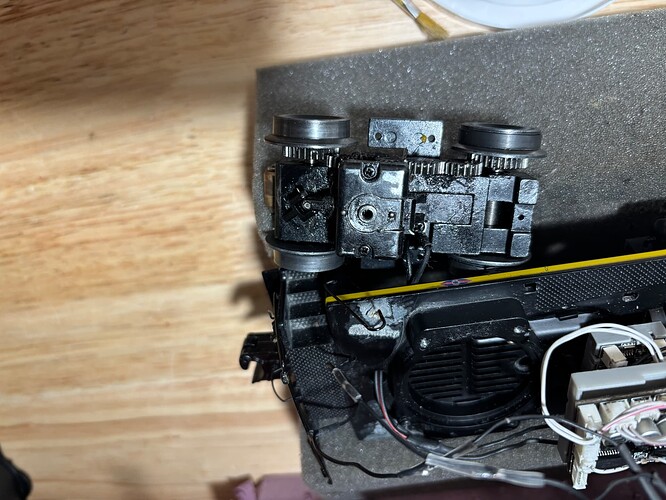

I’m not sure if there should be washers on top of the trucks on the Lionel Legacy NW2( product # 6-83393). Could someone let me know? What is the product number for these washers so I can order them. Thanks! Brad
Well, looking at Lionel’s parts diagram for the loco, there do seem to be washers as part of the truck assembly.
The question would be whether the washers (#49) are actually for that specific part of the truck. I’d guess so.
Dimensions are given in decimal inches as
.088" ID x .256" OD x .020" thick
You might be able to modify a similar washer to these dimensions, or make something from a piece of stock.
