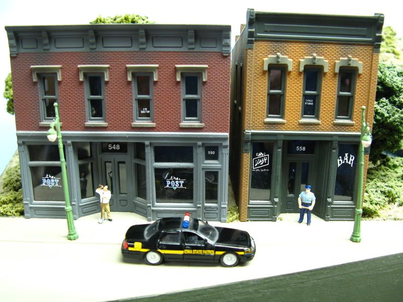

I don’t see any gray mortar lines at all. I see red mortar lines in red brick and yellow mortar lines in yellow brick. That to me is very unrealistic.
Hold on gents, before this becomes a full-fledged pissing contest, both ways work. For the what it’s worth,the question should be answered by more questions, how old is structure? If it’s 80 years old, much of the mortar may be black from years of pollution. Something newer, say twenty years old will show mortar clearer. Also, myself, if the structure is closer to the edge of layout I may put little heavier mortar wash on than if it’s two feet back. A little prospective so to speak. If your veiwing a building one hundred yards away the mortar maybe just a little finer. Practice what works for yourself, it’s the best teacher. mh.
I have to agree with Jeff: “less” can be “more”, but in the case of your nicely painted buildings, “less” appears to be “too little”, at least as far as highlighting mortar lines. [;)]
