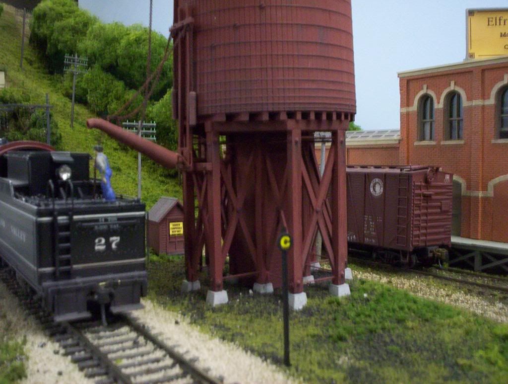

I use a combination of tank-mounted spouts and standpipes. The tanks are mostly from Atlas, but I replace the spouts with ones from Grandt Line:
For standpipes, I use mostly those from Tichy, either in conjunction with the Atlas tanks or scratchbuilt steel tanks without spouts.
For the double track past the main station, the Tichy spouts were too short to reach both tracks, so I built my own, using styrene tubing, brass wire and bits of styrene. The concrete pad is styrene, with the flared base made from the tip from a Bic pen. The longer spout is from Grandt Line. Below, the Tichy version is on the left, the scratchbuilt one to the right:
Here’s one of the scratchbuilt ones on the unfinished track near the main station, with the water tower to the right:
