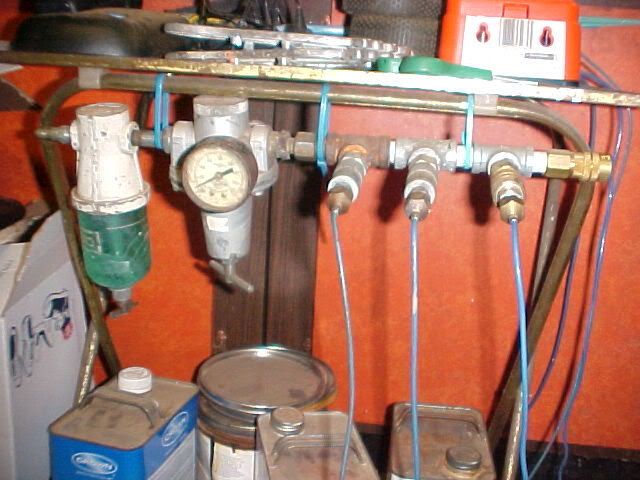

This is what I use for my airbrushes.
Regulator, water trap, and a few quick connects, for up to 4 airbrushes. A male fitting on one end of the manifold, to hook the air hose from the shop compressor up.
