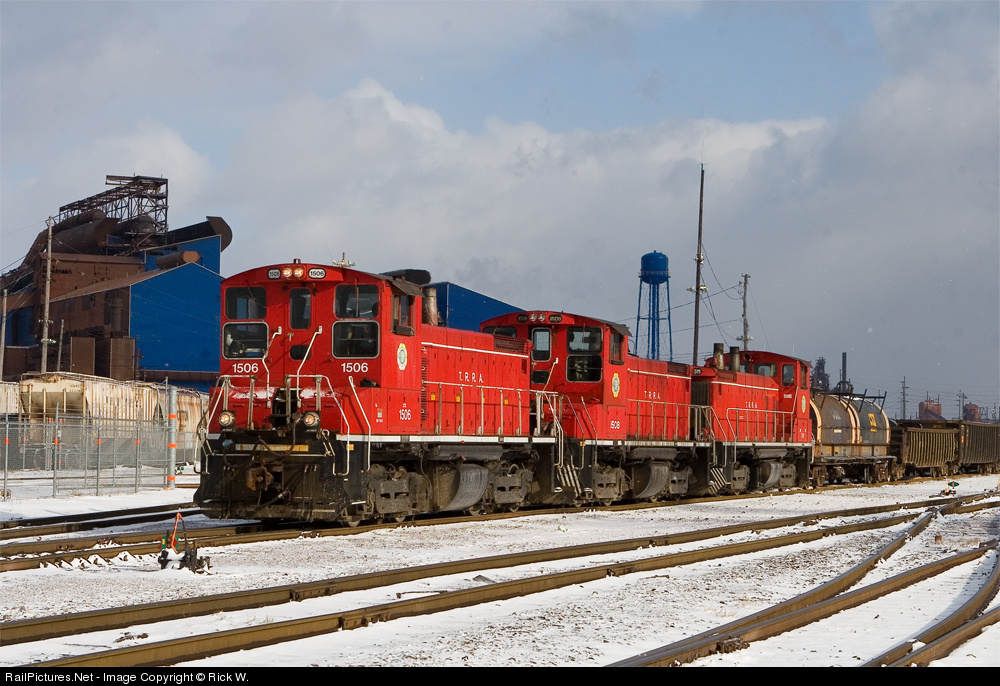

These are EMD SW1500’s - correct ?
Here’s a link to a photo from Dec. 27, 2009 of 3 of them - the 1506, 1508, and 1 other (I can’t make out the number) - being the last 3 in service, per the photographer, so there must have been at least 2 more already in storage. They certainly look well cared-for.
http://www.railpictures.net/images/d1/3/7/2/3372.1265900927.jpg
  • Paul North.
