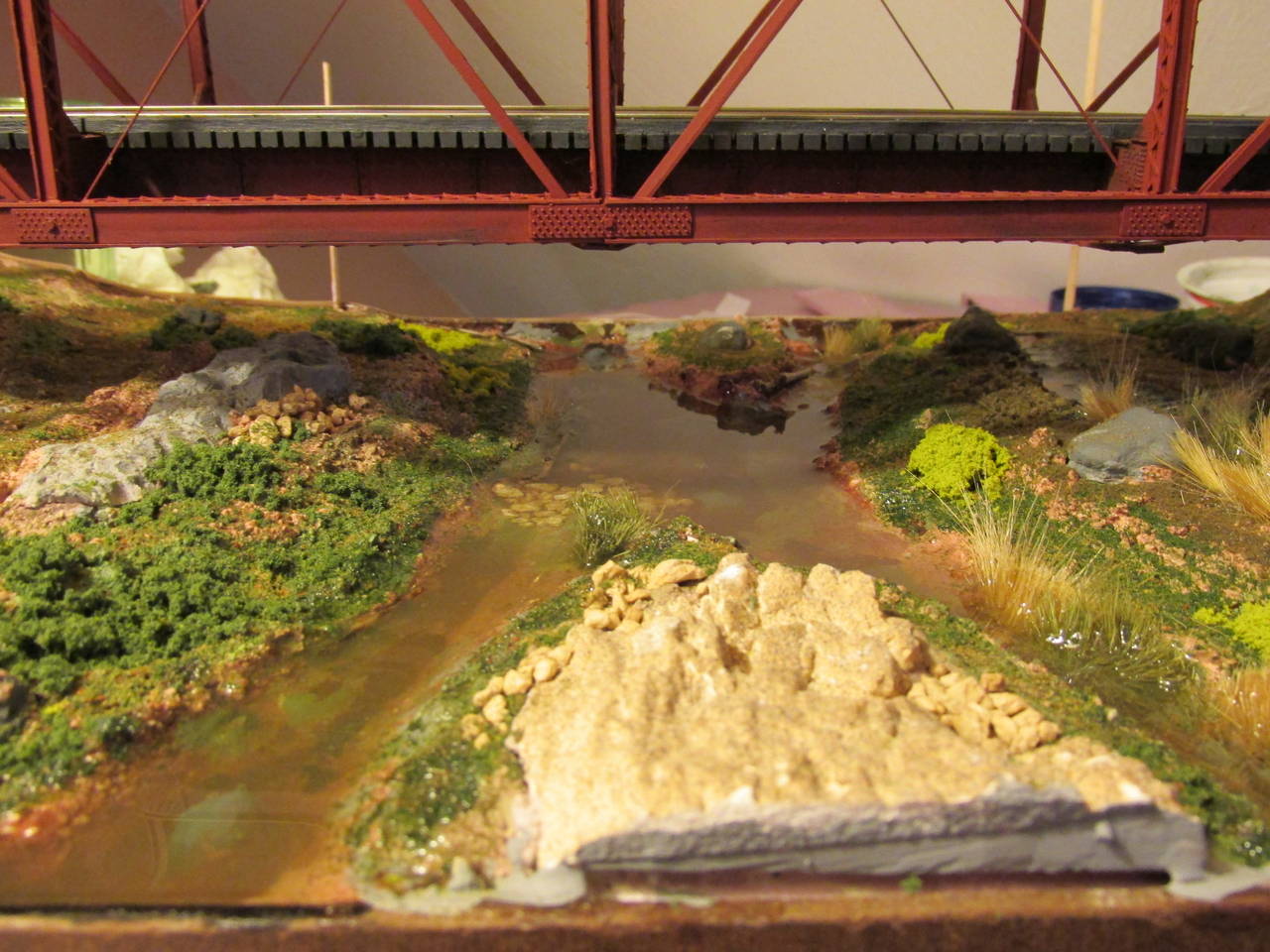

The bridge in this picture is nscale and slighly weathered.
The ME girder bridges parts where first airbrushed fadded black ( I use Golden acrilycs artist paint)
When dry I added some very small patch of rust color ( again Golden) whith a small brush, the color is diluted whith water.
Happy whith the result I come back whith some wash here and there of a natural grey stone (Golden again).
I finished the wheatering by brushing on the side of the bridges rust pigment.
The whole bridge was airbrushed whith a slight spray of a matte varnish (Golden again.
