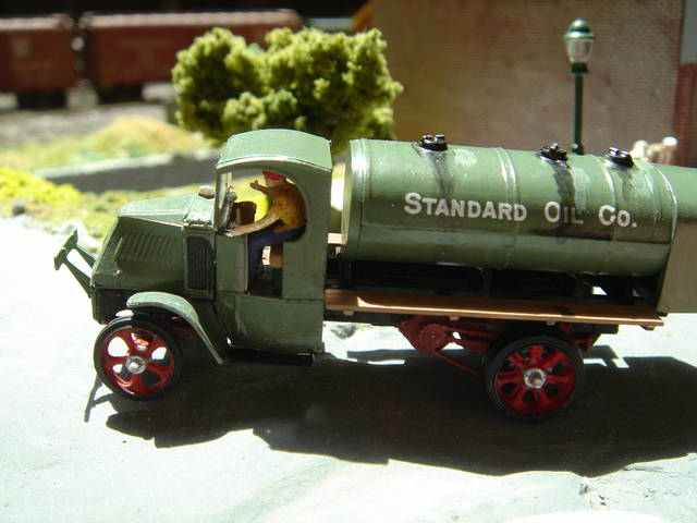

I put some spillage on this old Mack tanker:
