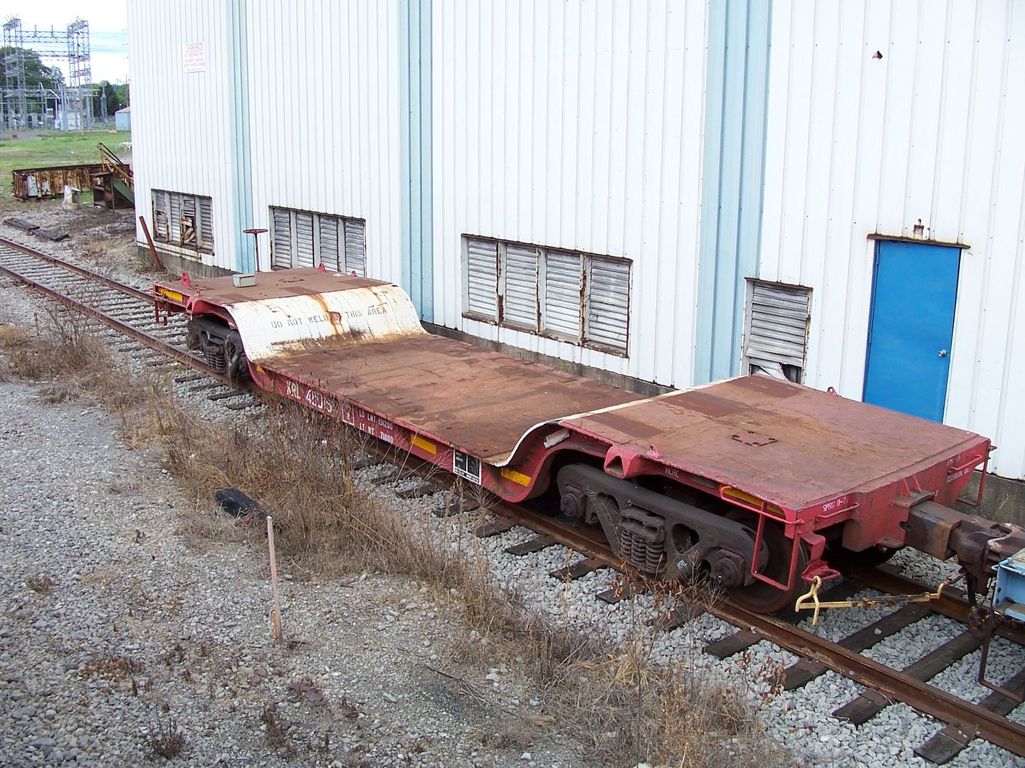

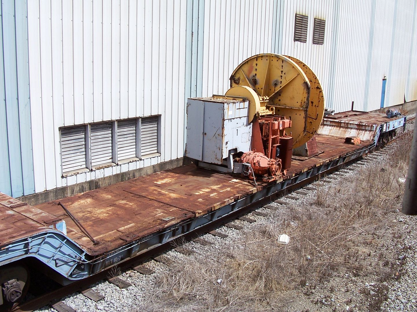

Here are a couple more, but mostly of cars with steel decks:

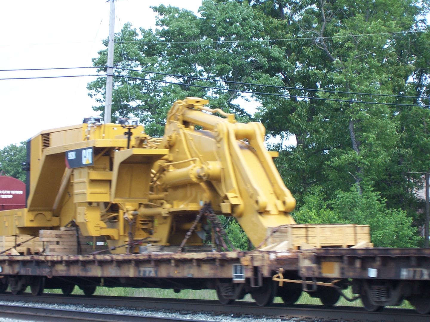

…and a couple of loaded flats:
