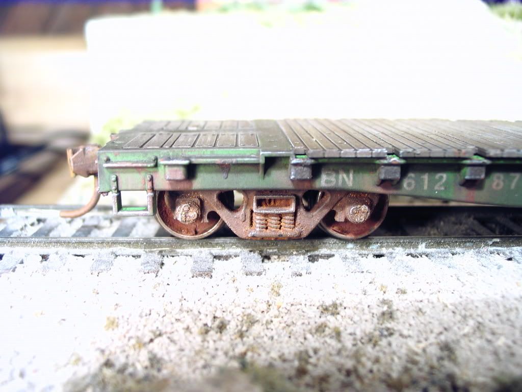

I used the following to achieve the results you see below.
  • Sophisticated Antiquing Rusting solution purchased from Michaels craft store
  • A.I.M. rust powders purchased through Walthers catalog
