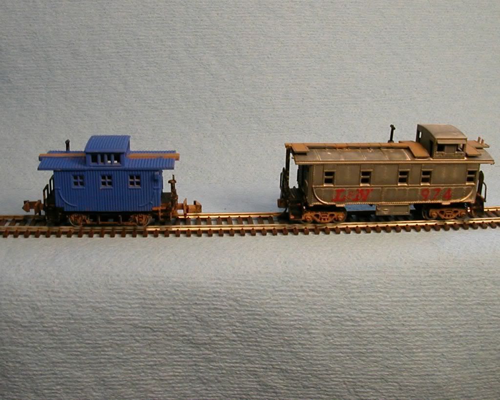

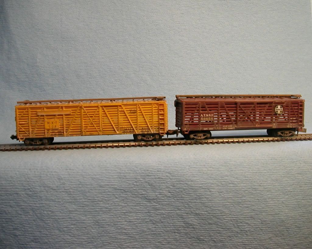

The L&N caboose was weathered with a very thin wash of several colors. I used the larger bottle for my air brush filled it 2/3 with water and added a few drops of gray, brown, black, ink, antique white. Not all at once mine you. I put on a coat, while it died I refiled the bottle and added another drop or two of paint. I worked on 7 cars at a time so the mixture stayed a thin wash. I did not like the way it beaded up, I made sure to wipe off the number boards when they seemed to bead up to heavily. Next time I am adding alcohol to the mix. After they dried it seemed to look OK.
Here is an older sot of the cars.
Here they are after 5 or 6 coats of the wash.
Edit: What gasturbine said about the paint going on dry is right, when you paint that is how you want it to work. The blue caboose (originally ATSF yellow) was painted like that but with the weathering I wanted something different.
