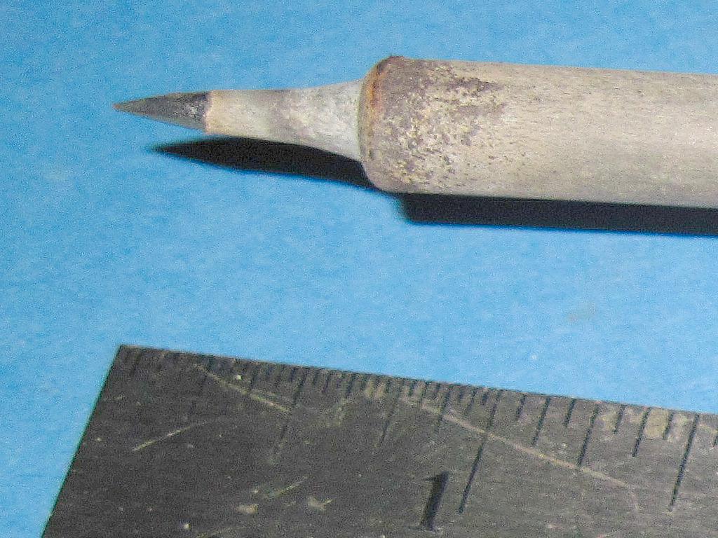

I should have posted the picture below, it’s a close up of approximately 30 hours on the tip.
Notice the slight narrowing of the tip between the solder and the iron. A fresh tip is not narrowed.
