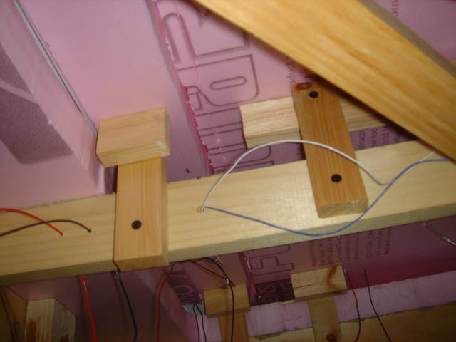

I have a simple, open frame bench, and I use 2-inch construction foam for my base. I use supports made from 1x2 lumber to elevate sections of the base to get higher elevations. Where I need to change the elevation of the track, I simply cut a piece of the 2-inch foam and use it for a ramp, supporting it at varying elevations to get it to climb. It looks like this from underneath:
I tried cutting a ramp out of foam. I had a lot of trouble getting the nice, flat contour I wanted. This technique of using a flat piece of foam and varying the supports works much better.
I cut an incline out of foam and can concur that it is both messy and tedious to get a nice smooth incline. It can be done, but there are easier ways. I have also used the method of plywood cutout but it also needs work at the top end to ensure a smooth transition.
