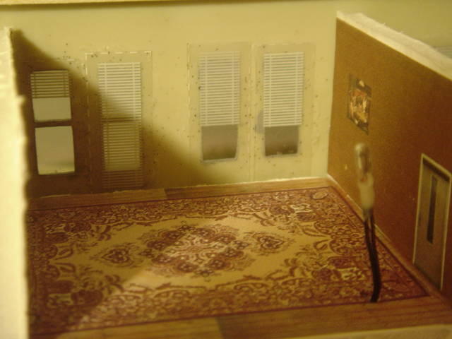

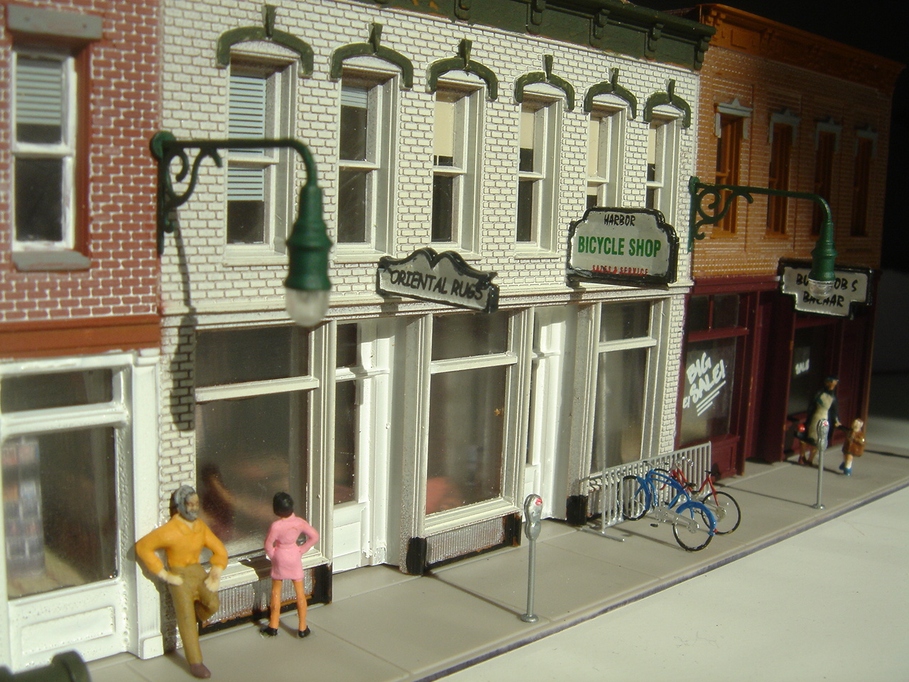

City Classics also makes sheets of window shades printed on clear plastic. Both pull-down shades and Venetian blinds are available. These apply from the inside liked this:
From the outside, they add a nice detail to the windows.
