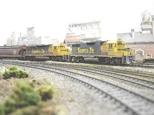

It’s more for a protection and it’s a dull look. Some people use it first before the do any weathering on a car. After you are done with your car you can spray it with dullcote. Also it give’s you a protection that won’t smear your weather job so you can handle it. Here’s a picture of my lastest work. This was all covered in dullcote.
Fantastic photography; absolutely fantastic!!

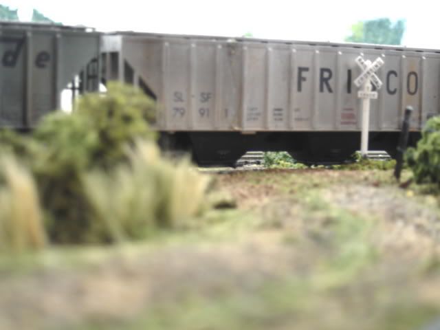

My first impulse when I read this topic was to shoot back to the poster, SD60M a question: are you weathering rolling stock or scenery/structures? When we mention weathering the impulse is to automatically think of locomotives and rolling stock; but those structures stand out in the sun and wind and dust and rain and snow twenty four seven and take a beating from the elements and weather just as surely as does that immaculately detailed F7. I do very little weathering of rolling stock using an airbrush; I do quite a bit of weathering of scenery/structures using an airbrush.
I do basically the same thing as you; the only place I use an airbrush in weathering rolling stock/locomotives is putting an initial coat on to dull the finish. I have only been using a very diluted grimy black for this step before proceeding with putting on the fine weathering details; your photograph, however, tells me I should probably add an airbrush step or two with some additional color. Right now I apply all of my rust
