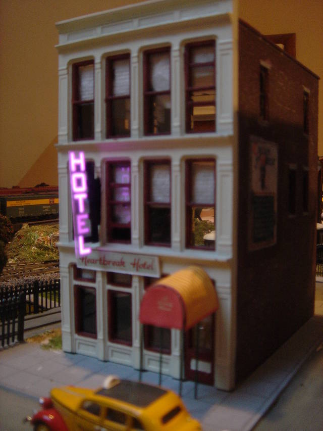

This is my current effort, turning the DPM “First National Bank” into the Heartbreak Hotel:
The Heartbreak Hotel sign is a decal, printed on the computer and then applied to a small strip of styrene. The awning is just printed on paper, and formed over a wire frame made from floral wire. I’ve been working out the details of this Miller Engineering sign, which actually sequences through the letters H-O-T-E-L. Of the 42 possible sequences that comes with the sign, I picked the one where the E flickers, as if it’s not quite a healthy neon tube. Very effective.

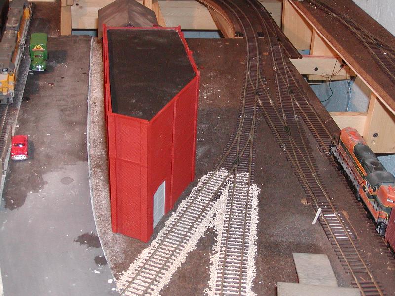

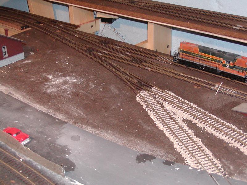

Odd size space
Solution
The building was built using one of DPM’s bulk packs. i don’t recall which one.
