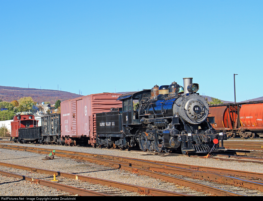

A very nice job. just repaint the orange tender and you’d have her fresh from the builder or shop. Paint the boiler and piping black and you’d have a nice short or branch line loco for the local or mixed after 1890 or so. After 1920, convert the headlight to electric by converting the acetylene one or installing a new electric one along with a turbo generator to power it (detail parts from Bowser for example) and she could serve until she was replaced by a hand me down steamer from a Class 1 which would give way to a EMD SW1, ALCO S1 or S3, BLW VO-660 or DS-4-4-660 or GE 44 or 70 tonner (all available in HO)
As a teen, I used to pedal my bike down to Cranford Junction (Aldene) where the RV interchanged with the CNJ and B&O’s SIRT subsidiary and I went to school at Penn State - where the BC provided coal to the University power plant and general freight service to the town of State College
Rahway Valley finished out the steam era with two second-hand 2-8-0’s and went on to GE 70 tonners
Rahway Valley 15 - Wikipedia
GE 70-ton switcher - Wikipedia
Bellefone Central, with its heavy gypsum traffic went with more powerful power and replaced its old steamers after WW2 with three ex-PRR
Thank you. The 4-6-0 is still being built. It will be “modernised” as you mention, and painted up kind of like this 4-4-0, also built from a tyco 4-6-0 boiler, but shortened to fit the MDC 2-6-0 chassis, which in turn was converted to 4-4-0. The MDC cab was used as well here. The close up is brutal, showing it needs some touch up paint…
Thanks for the photo links. I really like 70 tonners and the like!
