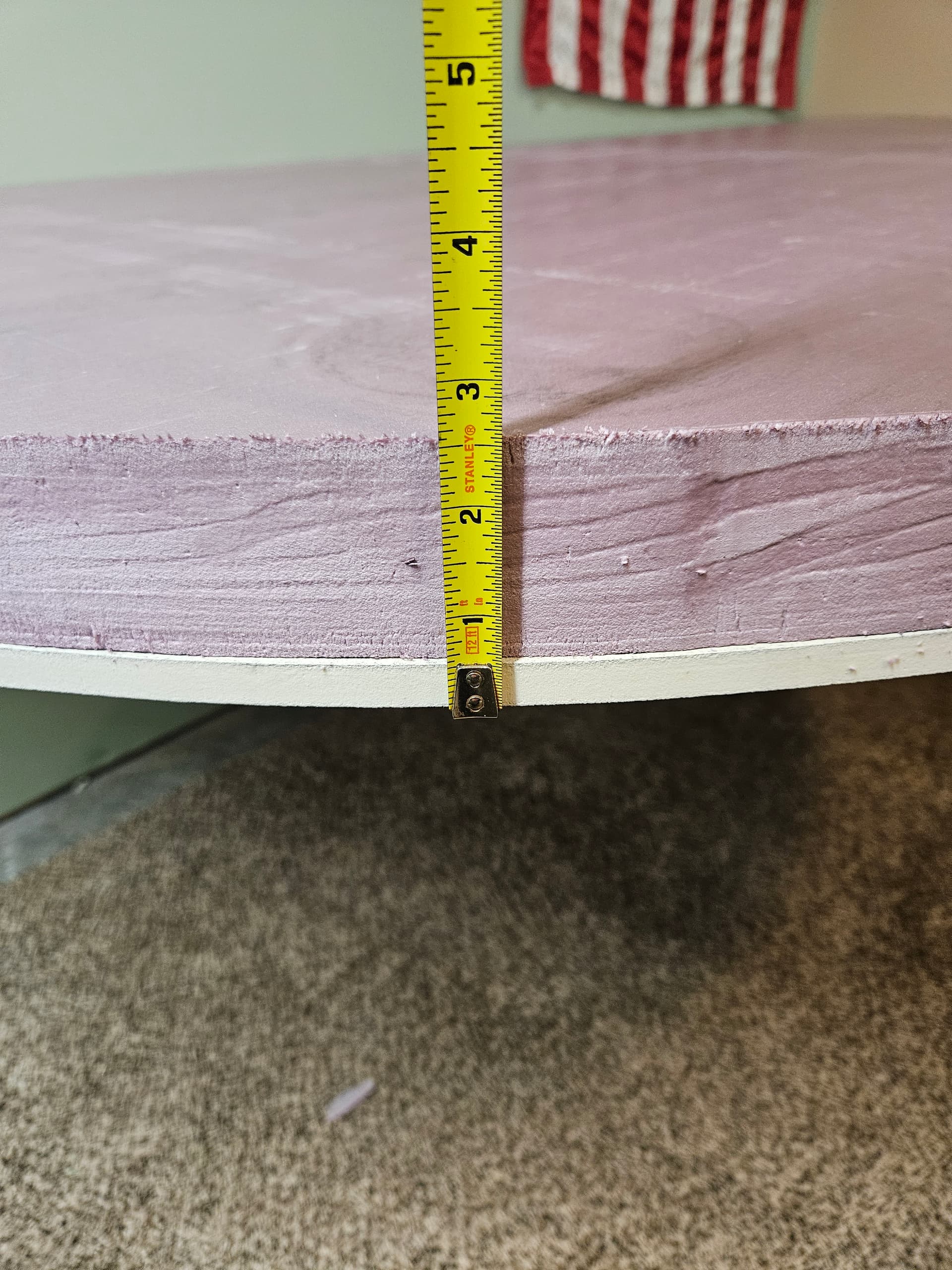

On my layout I have 2" pink NGX extruded foam board on top of the Go Board (lightweight Go Board used in lieu of plywood base)
To make a small lake for my campground scene, I need to relieve about 1/4" depth of 60 sq. inches of it.

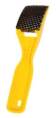

There is a tool that is made out of the same kind of blade that a drywall rasp is made of though smaller and curved in shape it kind of has a handle like a paint brush. If i could find mine i would post a picture
This is what I use – a surfoam. It makes a mess, so you will need a shop vac when you’re done. It’s also cheap!

York thats exactly what im talking about. It dose a great job and smooth transitions.
