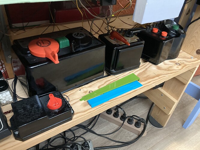

I have a variety of transformers kicking around, some get more use than others but I don’t have a permanent O, S, or Standard gauge setup, so it’s easy enough to switch and swap what I use.
While I love my ZW and it’s absolutely worthy of its reputation, frankly I just as much enjoy the single throttle LW. I just can’t get enough of that stylish light up dial with the green pilot light in the middle. Not to mention it’s got enough “umph” to handle pretty much any single or dual motor loco I might want to run. I think it’s my default transformer to pull out when I want to run my O gauge. I may only have one that is currently operable, but I have another 2 or 3 that are OOS, awaiting some varying degrees of repair work!
For American Flyer S Gauge, my 12B is my usual favorite. It’s powerful, gives me little trouble, and I like the look. Plus I got it fairly cheap!
I tend to run my Standard Gauge with a Lionel type Q, because it’s currently the only pre-war transformer I have with continuously variable voltage, not to mention the only prewar transformer I have that is in operable condition. Plus it has the up-to 24 volt range, if I need it (so far I have not).
I have a 1044 that I occasionally use when running late '50s/'60s era Lionel, just for kicks. Most of the time though, I hook it up to a Lionel 0150 “Recti-Volt” and use it to operate my postwar HO scale Lionel, Flyer, and Marx, a task it is most readily up to. Eventually I would like to supplant this setup with a Lionel 0100, which shares the same case and handles as the 1044. In my opinion, it is the best transformer Lionel offered for its HO line.

I use a Type V as well, but I’ve also got a 1033 (plus one that I still need to fix) and about three little transformers.

I like the style and power of the LW, but I never get above 16 volts. It goes up to twenty. The TW is a fantastic transformer, I have wired it to my “ Flyover” track. It goes up to 18, and has additional taps for accessories. More power than I probably need. It also runs through a knife switch, delivering power to either the Flyover, or an American Flyer loop. 1033 is great , but less power. A 1053 runs an 0-27/ Marx loop. American Flyer 8b is more than adequate for most Flyer needs.
