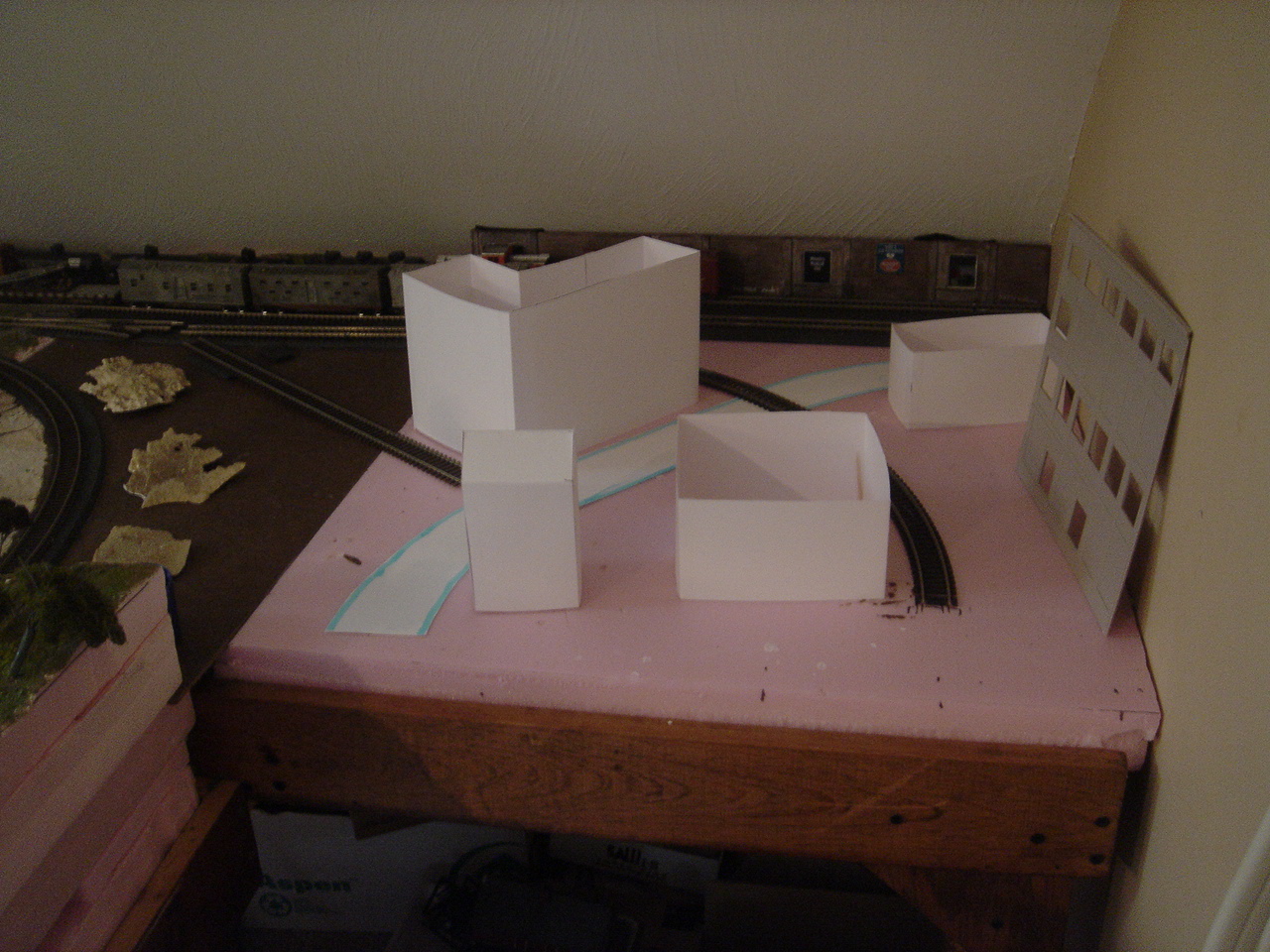

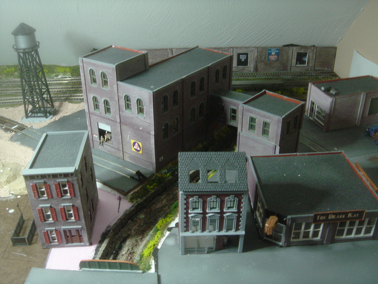

I have built scene by scene. Typically, a scene is a square foot to 3 or 4 square feet. Since I have a lot of urban scenery, that will usually involve a cluster of buildings and roads. Or, a scene might focus on a waterway.
I sometimes cut pieces of cardstock to represent the footprint of buildings, but more recently I’ve been building simple paper mockups to get a 3D perspective.
This
became this
