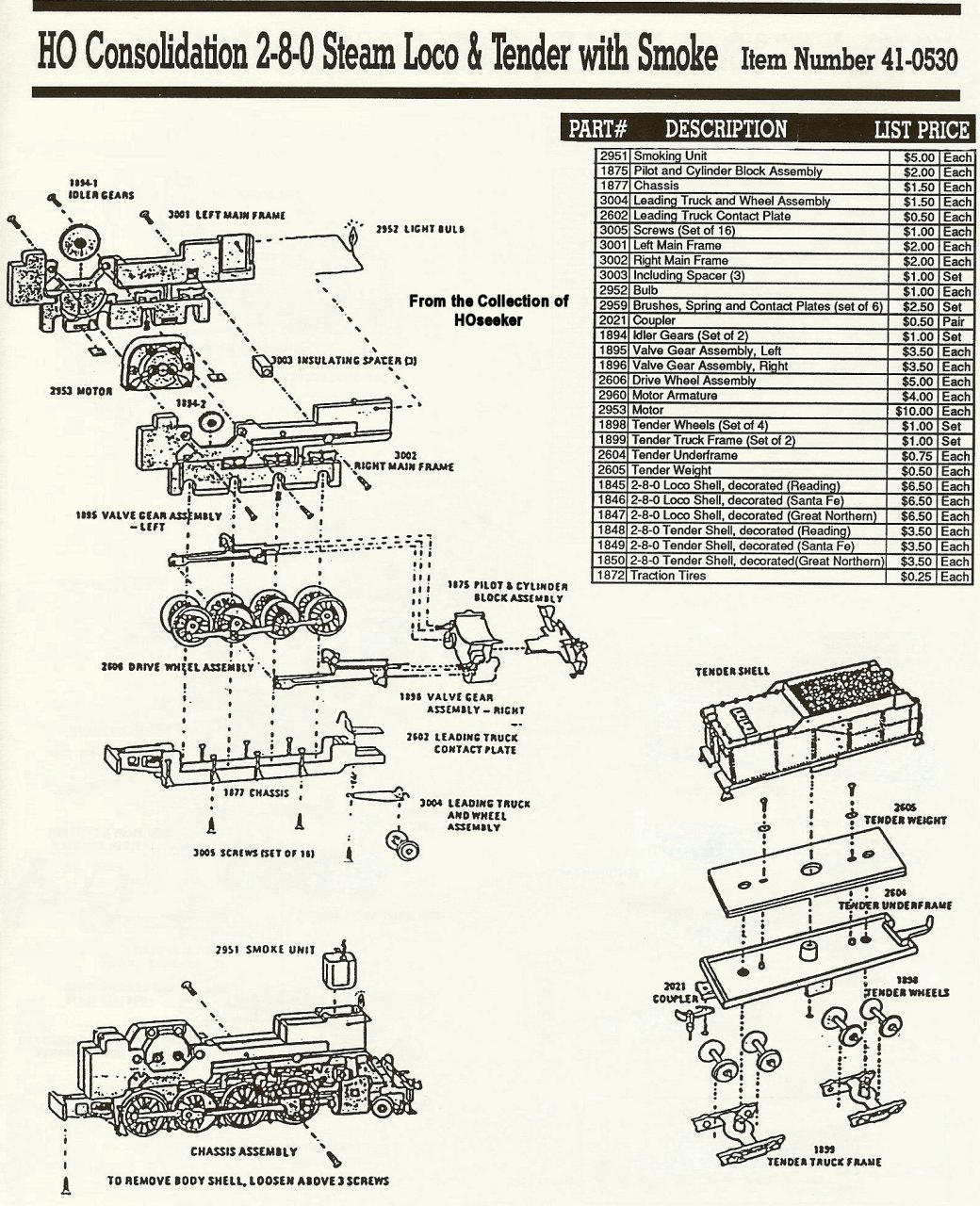

Are any of the below like you have?
Can motor style.
http://www.bachmanntrains.com/home-usa/dwg/dwgs/H114X-IS001.PDF
Pancake style motor.
http://www.hoseeker.net/assemblyexplosionbachmann/bachmann280consoliddiagram1990.jpg
Actually, there were 3 2-8-0’s in the Bachmann Line. The base Bachmann , sometimes labeled as Bachmann 5. I truly is not worth fixing. El cheapo, pancake motored running gear. And as Jim pointed out, the Spectrum 2-8-0 that we all love, came out in 1988. (yes, 1988) . There was a 3rd 2-8-0. From 1992 til 1996 Bachman produced their “plus” line. These were, on the outside the same engines from years before, but with internal upgrades brought from the Spectrum line. (including a can motor) Kind of a “mid grade” until more stuff could be brought into the Spectrum line
I’ve got 2 of them. They look like the original 2-8-0, but the run like a Spectrum. Oddly enough, they are doing better than my Spectrum consolidations as my newest 2-8-0 has had to have a motor replaced already [^o)]
I BELIEVE I HAVE THE SECOND TYPE YOU LISTED UNDER PANCAKE STYLE MOTOR.
