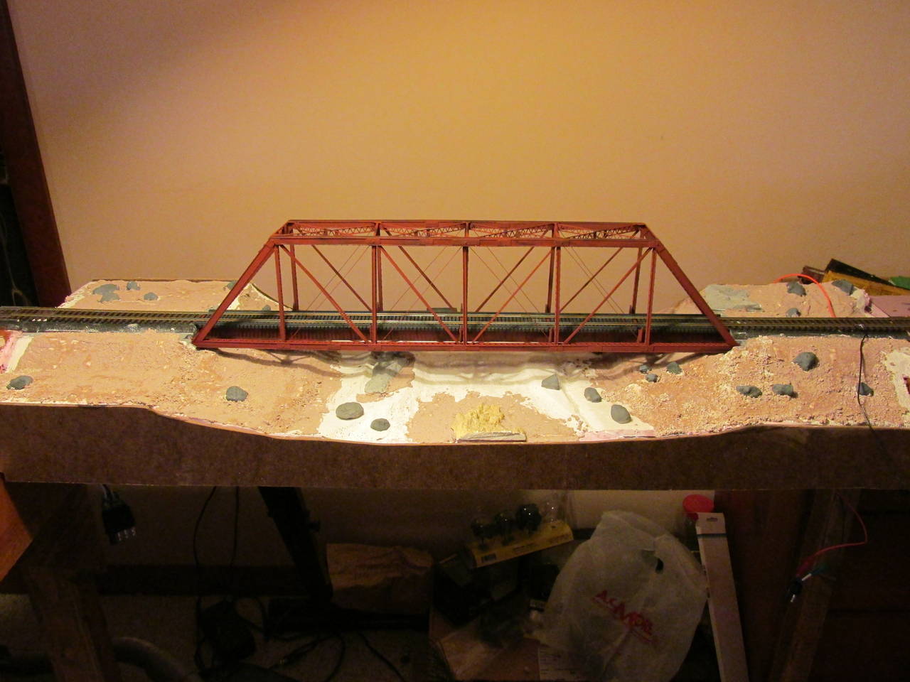

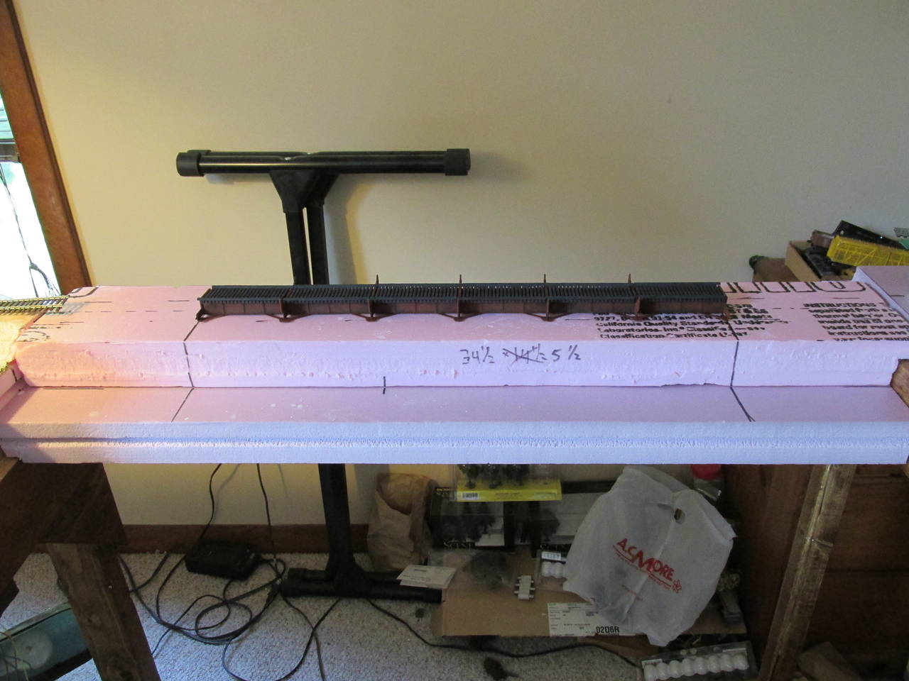

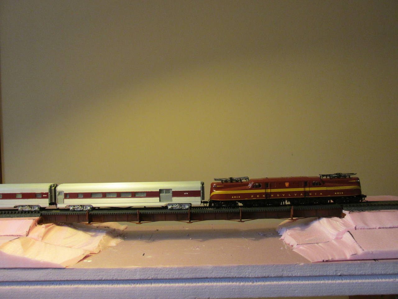

I like to include the bridge with the initial trackwork, but I don’t usually fasten it solidly in place until the scenery beneath it is complete. My layout base is pink foam and I use WS foam roadbed, so I can hold track in place with U-pins made by opening up paper clips. By doing this, I can have the track in place and run trains while I slowly craft the scene around the bridge. This is a Central Valley truss bridge. The deck portion bears all the weight in the kit. I built that first so I could use it to figure out how the scenery below it should be done.
Next, I cut into the foam to make the river bed. With the base of the bridge already built and the approaches available on both sides, I could both test-fit the bridge and run trains over it to check the trackwork and electrical connections.
The scenery work took place over a couple of months, while I was also adding more benchwork to the far side and putting in a long 4-track staging yard and a single through track. By having the bridge in place, I was able to test the trackwork all the way through. Meanwhile, I add layers of scenic material, from foam to plaster cloth to Gypsolite and rock castings. The superstructure of the bridge took some work, too.
I just finished the final scenic steps this weekend: ground foam and turf, Envirotex for the stream, static grass, trees and a moose. The first picture in this group was posted on August 10th, and the last on October 25th. The bridge was under construction before that, and I’ve still got to ballast the approach tracks, so this was about a 3-month project, working on-and-off while doing the staging yard. I’m not retired yet, eithe
