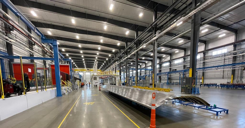

Seems that Alstom was not allowed to bring in the shells from their main fabrication plant in Brazil due to all the tax incentives and subsidies. So they built “Plant 4” in Hornell into what is a robotic steel shell fabrication facility. That is what took so long it appears.
Now I have questions about exactly how passenger railcars are made, because I just reviewed the Alstom Hornell facility and also the Siemens Mobility plant in Sacramento.
Alstom Plants 2, 3 and 4 don’t have any rail service to them. Only Plant 1, which has the turntable and a test track with catenary next to it. So are they going to roll the shells down to Plant 1 on a truck the 1 mile for final assembly? It seems terribly inefficient.
