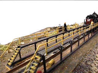

Model Power had some in plastic.
In addition to the good suggestions above, if you Google Images search for ‘HO scale service platforms’ you’ll see other ideas
incuding:
Diesel Engine Service Platforms (traincat2.com)
Dave Nelson
Hi Dave,
By the look of them, those are great platforms, and they are way cheaper than the NJ International ones that I showed above. Much better product for way less money. Win win!
