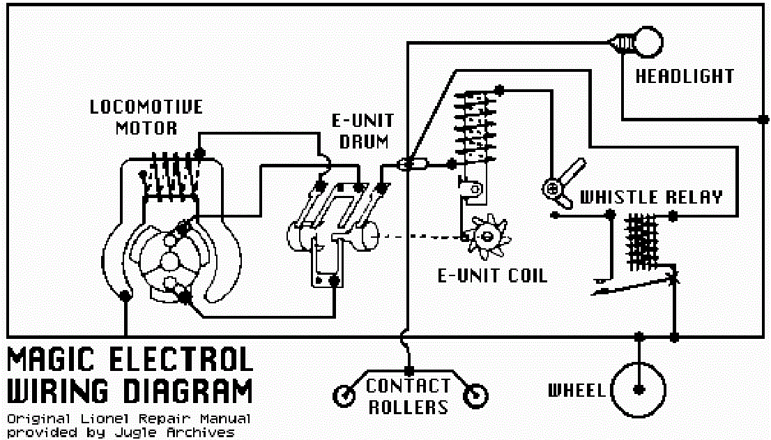

Lionel calls this "Magic Electrol"

Looks like ‘Magic Electrol’ would be a cure for e-unit buzz?
The picture is awesome. That will really help out. So can I still use a horn if I have a separate horn button and relay for the horn?
Yes, but your couplers will activate at the same time. In reality, it’s one or the other.
