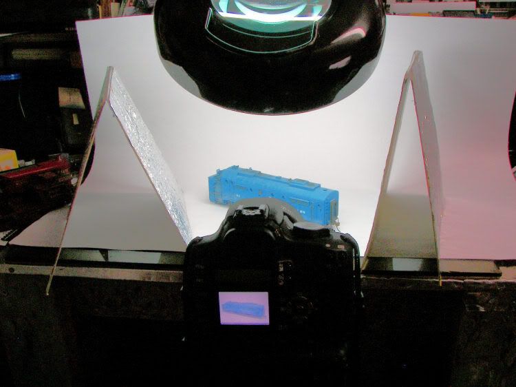

Here’s my setup, using white cardboard which is better than cloth as it does not wrinkle. Using my desktop lamp/magnifiyer and two reflectors made from cardboard and crinkled up aluminum foil. Much of this is shown in my photo website, in my signature.
(click on photo to enlarge)
