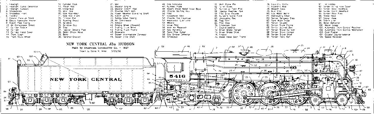

If you are talking about this:
…it is the throttle. Bradford type.
Vents on FWHs are small pipes.
Engines with a trailing truck booster engines will exhaust through a medium size pipe just ahead of the smokestack. This second plume of steam can be seen on videos of the C&O 614 when the booster is operating.

That is the exhaust stack for the booster engine, not anything for a FWH.
I’m quite prepared to believe that, but not all J1 Hudsons had the stack when new although they appear to have boosters fitted. Many j1d have no small stack and a booster. On the other hand, a post war photo of a J1e shows that stack missing, although there is still a steam pipe past the firebox.
Where did the booster exhaust on locomotives built without the small stack?

Someone could probably write an article on all the different methods and theories regarding routing of booster exhaust. The issue can be complicated by the same argument regarding the ‘secondary’ escape pipe on the Triplexes: do you, or don’t you, want to use the heat and mass contribution from the booster exhaust to make draft?
The ‘typical’ installation for the original boosters (and auxiliary locomotives; I’ll be agnostic about suppliers) discusses providing a separate nozzle in the stack arrangement for the booster piping, which I always thought would involve incorporation in the blower ring through a separate manifold. Very, very early this was changed (although the ‘reasons’ were not carefully enumerated) to the typical arrangement bringing the exhaust up to just behind the stack. Meanwhile, on a J1 with the typical Elesco, the booster exhaust could be brought up past the superheater header and shell ‘invisibly’, at the cost of a bit of additional pipe, and routed ahead of the stack where it would interfere less with the fireman’s ability to ‘read the exhaust’. I suspect this routing might change if the locomotive later received a Worthington FWH … probably to the ‘standard’ location behind the stack with external plumbing, but you might consult photos.
Note the arrangement in the drawing of the J3 that has been posted. This was comparatively late practice on a locomotive class that could be expected to use a high-speed booster right to the end of its nominal speed range in some cases.
