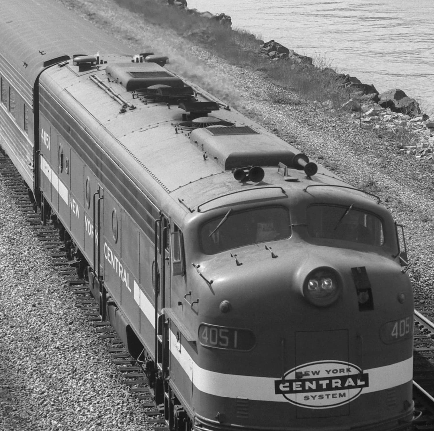

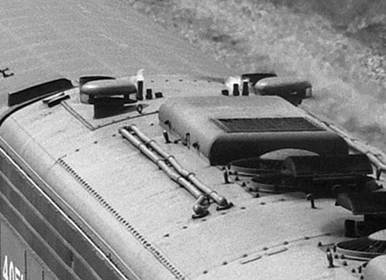

Steam Generators had a steam exhaust valve that could be manually opened by a Boilermaker servicing the unit. It was #18 valve if I recall correctly, it allowed steam to be released safely into the air instead of out the train line just outside the shops for example.
Some E8s and maybe others, were built with two steam generators.
The engineer is donning a tie!
Photograph by Victor Hand.
Regards, Ed
