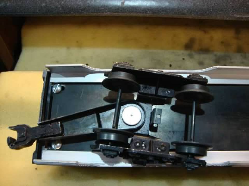

I thought I scored a great deal on a Williams 2530 repo of the Lionel baggage car to go with the 2500 series passenger cars I got in a package deal. Thing looks great,BUT it un-couples on curves, it also derails over Lionel road crossings and switches ??? Any ideas? I could sure use some help on this one?
one coupler hangs kind of low the other is spot on but place it either way and they still un-hook?? I have looked at everything and just don’t get it. I am pulling the four car set. My min curve is a MARX 34" ![]()

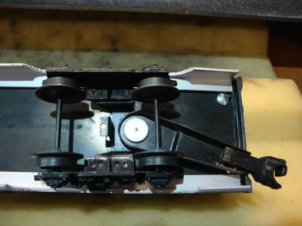

Trucks are lubed and run free. Couplers are solid and don’t open up. Cable ties will do no good. They just slip out of the Lionel couplers going around a curve. I have never seen trucks like these?

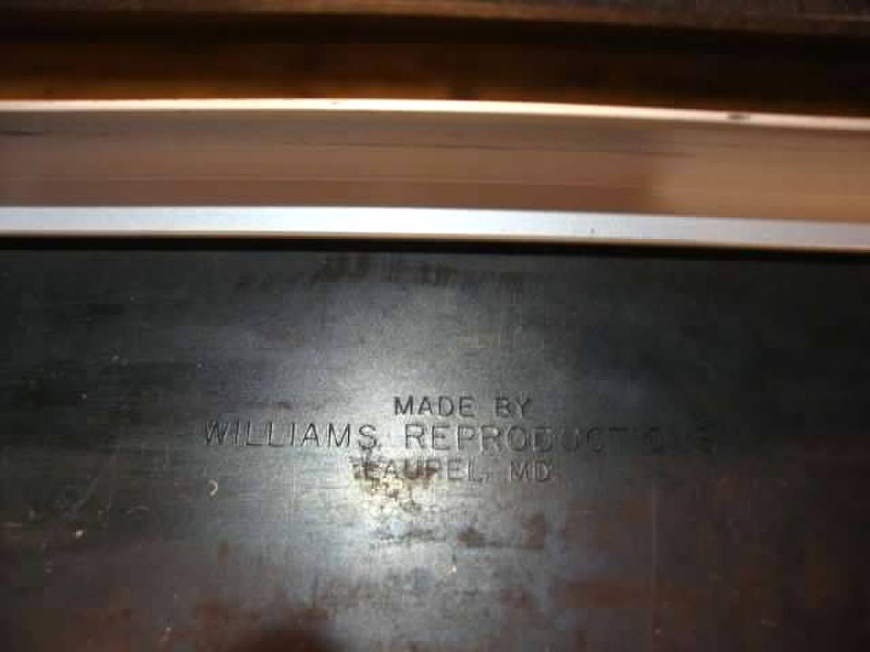

Thanks but this is Not a heavyweight 6 wheel car it is a repro of the 1955 Lionel 2500 series passenger cars. The Lionel baggage car has no-lite and has a 490-1 Lionel truck like this. I have seen this style truck on other Williams 2530 baggage cars listed on E-bay but never seen the ones on my car?
Me neither! On anything. Those are darned unusual!
After looking they seem to be correct for Williams Golden Memories around 1980, Maybe even in the Kit form?
No matter,they SUCK!
Becky’s probably right, replace them with Lionel trucks and couplers.

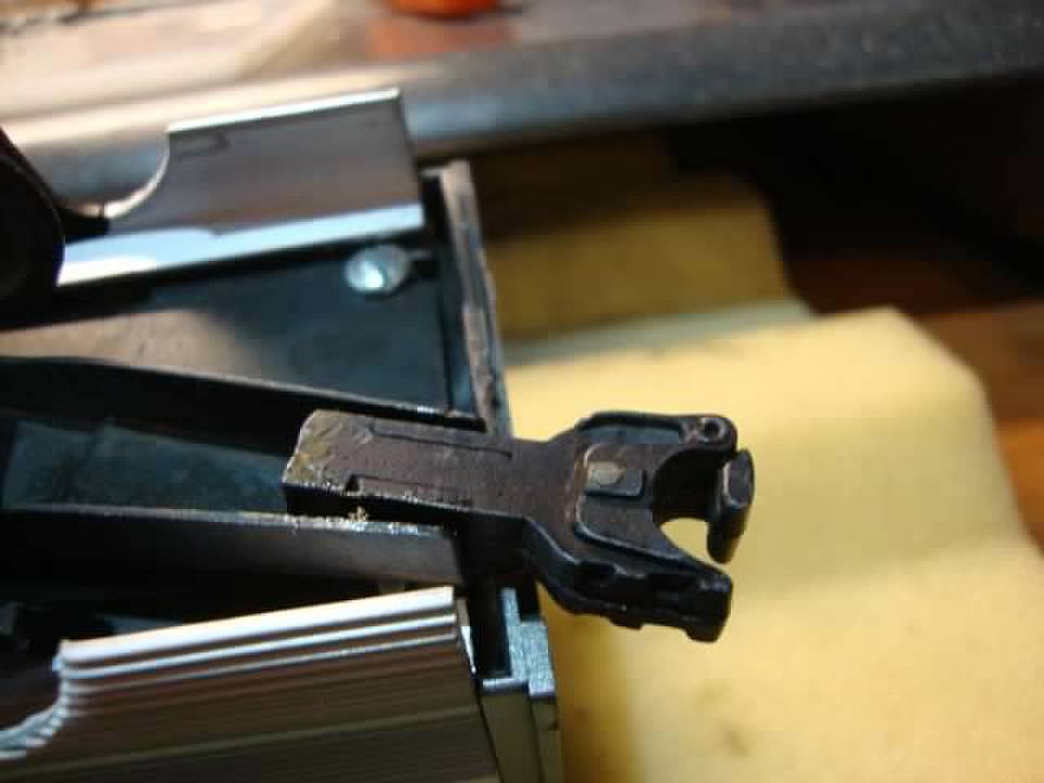

My best guess is that somehow the couplers are able to wiggle up and down? As in, there’s play in the pivot of the coupler that allows it to move vertically.
Initial thoughts are to see if you can reduce any sort of play like that. I’ll have to check out my car at some point to see if that helps me understand what’s going on. I haven’t had issues with mine, but it isn’t mating with another solid coupler williams car so that might not tell me much.

Working on a set of TCA Anniversery Madisons that I just picked up. Drag was horrible. Solid couplers on some cars had the same uncoupling problem. Carefully removed the wheels ans axles from the trucks. used a dremel with a wire wheel to remove the paint from the end of each axle. Spayed with silocone lubricant. they roll better . While the trucks are apart preen the coupler rivit to tack up the lateral play in the couple. They are still far from perfect, but better.
