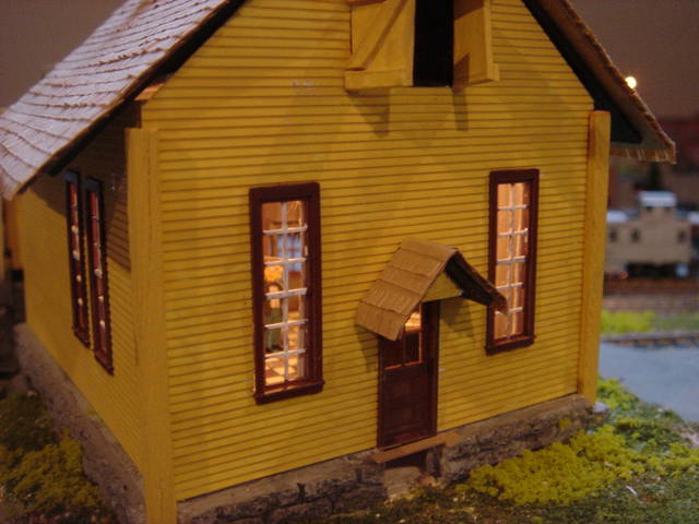

These are Tichy windows. The door is, too, as I recall. The attic door is scratched.
The door that came with the office is the same as the plastic insert door you see in the grain bin. Blath! Ugly and boring. So out of scrap I made a door that is open and it also has a window in it. I also made the door frame and sill. All out of little bits of scrap.
I have since done some windows and other doors and they are easy to do. I have also used microscope slide covers for windows and I think they look way better than plastic windows.
If you are scratch building the structure, why not the windows and doors? So little material is used, you likely already have it in stock and already paid for is good.
