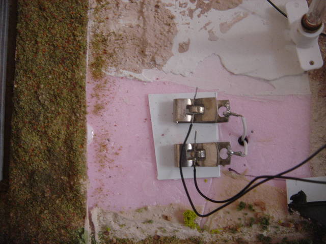

I’ve been using Fahenstock Clips to connect structure-mounted lighting to my layout. You may remember these from your old Lionel days. Lionel used them a lot. I bring the wires up from below the layout and solder them on to the back of the clips in the holes provided. Then I CA-glue the clips to a pieces of scrap styrene, and attach that with white glue to the foam layout base.
This gives me a permanent pair of clips, and all I have to do is connect the wires from the structure. These happen to be for a Walthers wall-mount light above the door. In this picture, you can also see the bulb for the interior lighting in the building, which is mounted to the layout base.
I tinned the ends of the two black wires going to the clips. It’s easy to remove these if I need to take the building off the layout for any reason, but I get a good connection when I put them back.
And, they’re cheap. I got a package of 25 for about 4 dollars.
